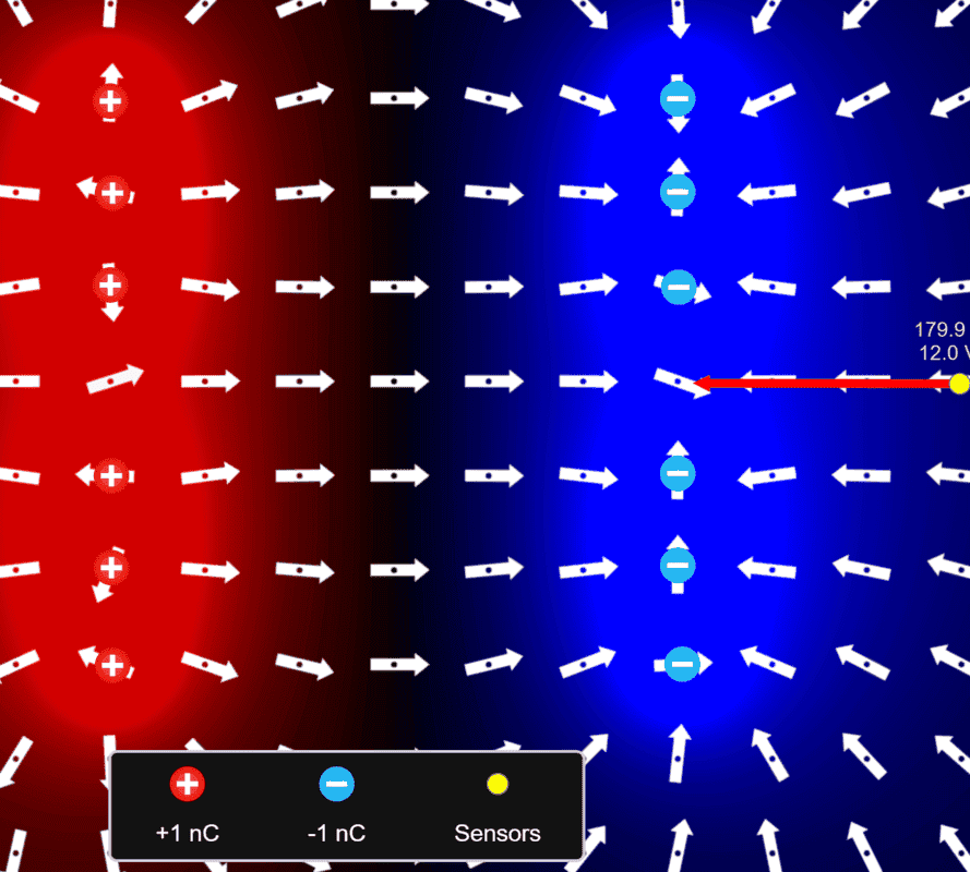

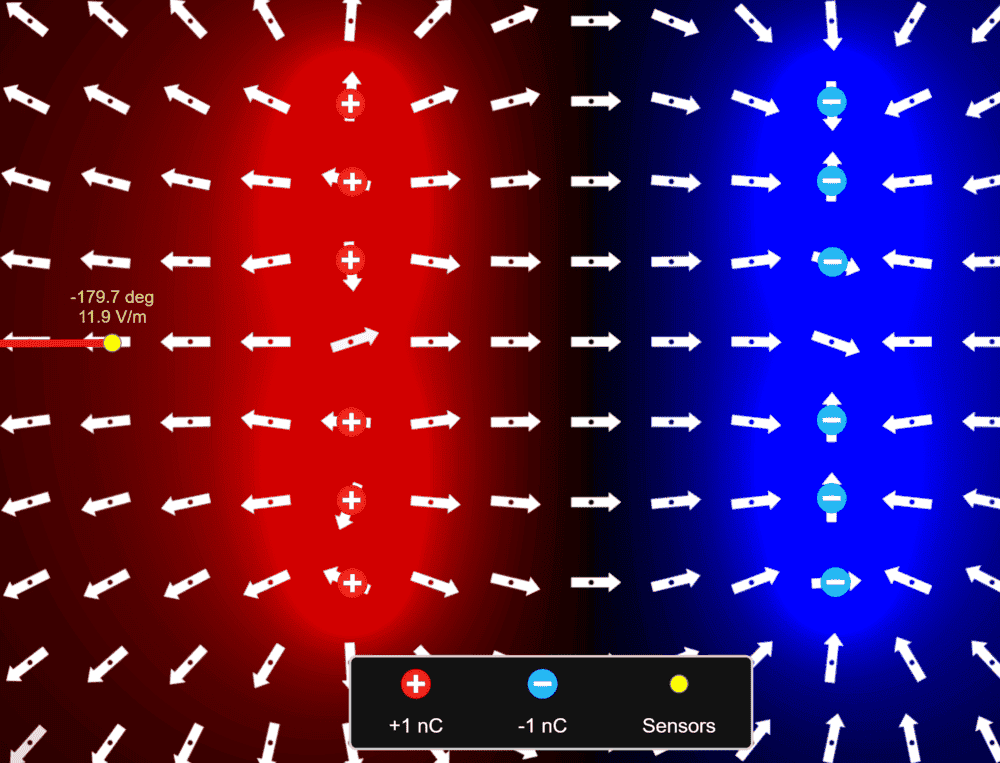

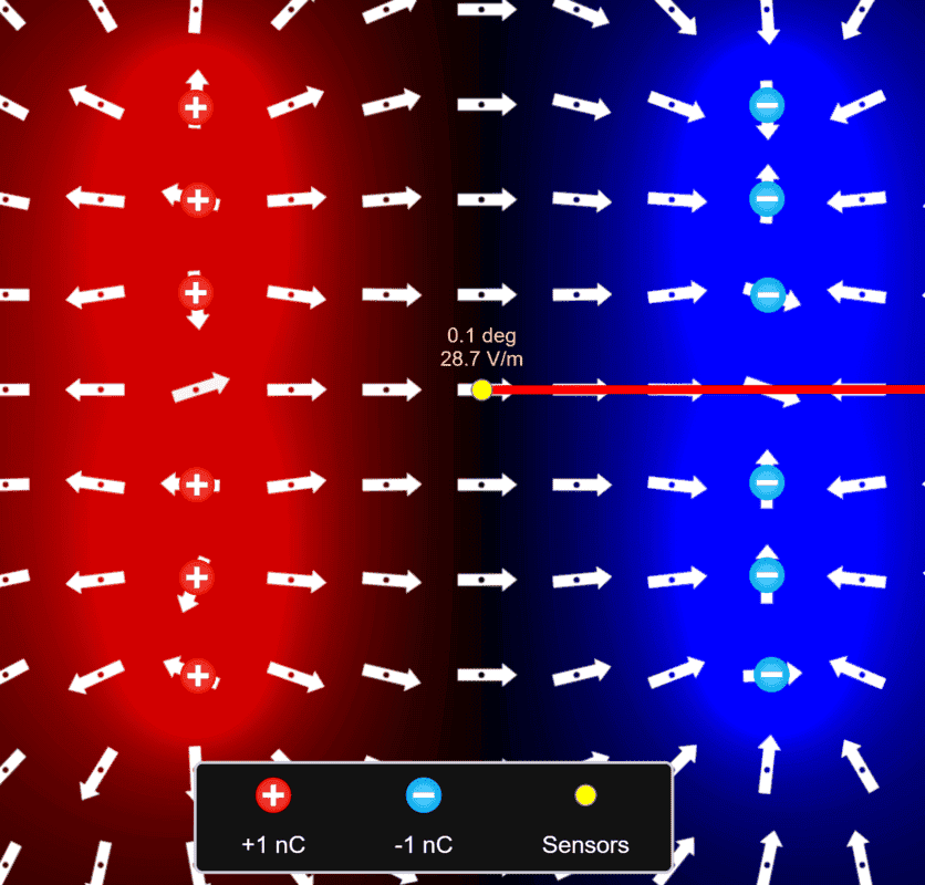

In theory there should be minimal charge on the outside. For an explanation see this Quora article. If the plates didn't affect the field on the outside of the other one, yes all energy would be lost as the particle travels to a point about half the width of the capacitor away from the exit plate. However they do effect one another and the field at the two points w/2 away from each plate on the outside is less than the one point in the center on the inside.
241808
241809
241810
In the above above screenshots from the Phet Charges and Fields simulation ( which can be downloaded here for free) you can see that at the same distance, on the outside you have about 12 V/m, while in the center you have 28.7 V/m. This is 24 on the outside with 28 on the inside, resulting in a net imbalance in energy in and out.

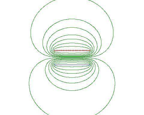

In reality you have the fringe fields, because the plates are not infinite, which in this case shouldn't be neglected. Instead you end up with equipotentials that look somewhat like the following:

You still have the angular part to consider though (i.e. the equipotential lines are more dense off to the side of the capacitor than directly behind it. Other things to consider would be if the fringe fields would result in a net field between the oppositely charged plates of capacitor 1 and 2 and how that would affect the kinetic energy of the charge.
The mere existence of potential lines is enough to show you what's wrong. The "return" leg in your pdf involves crossing all the same equipotential lines you crossed in the other direction on the "forward" leg.
Likes SammyS
See above comments, and the field in the return portion is significantly mitigated.
You cross the same equipotential lines in both directions. You cannot get back to the start otherwise. So it follows trivially that the decrease in energy in one direction is the same as the increase in the other. The rate at which you cross the lines (edit: and the path taken to cross them) is immaterial.
I don't know what mental model you are using, but it's wrong. You are describing a circumstance similar to sledging down a hill then climbing back up the hill to sledge back down. You could theoretically do that as a closed loop if you could eliminate friction entirely, but you cannot extract energy from it.
Likes Dale
alright, makes sense. Thank you.
