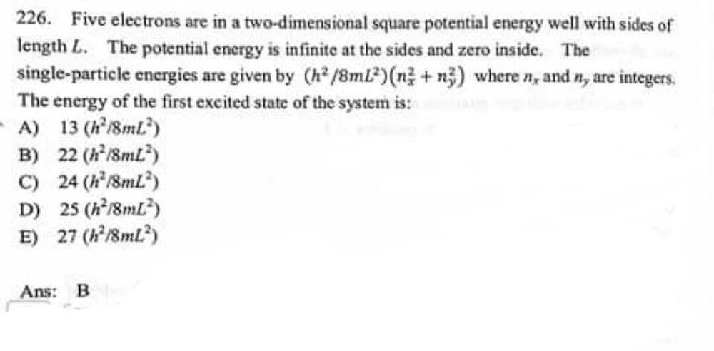

Five electrons are in a two-dimensional square potential energy well with sides of length L. The potential energy is infinite at the sides and zero inside. The single-particle energies are given by (h^2/8mL^2) (nx^2+ ny^2) where nx and ny are integers. The energy of the first excited state of the system is
(A) 13 (h^2/8mL^2) (B) 22 (h^2/8mL^2) (C) 24 (h^2/8mL^2) (D) 25 (h^2/8mL^2) (E) 27 (h^2/8mL^2)
the correct answer is B

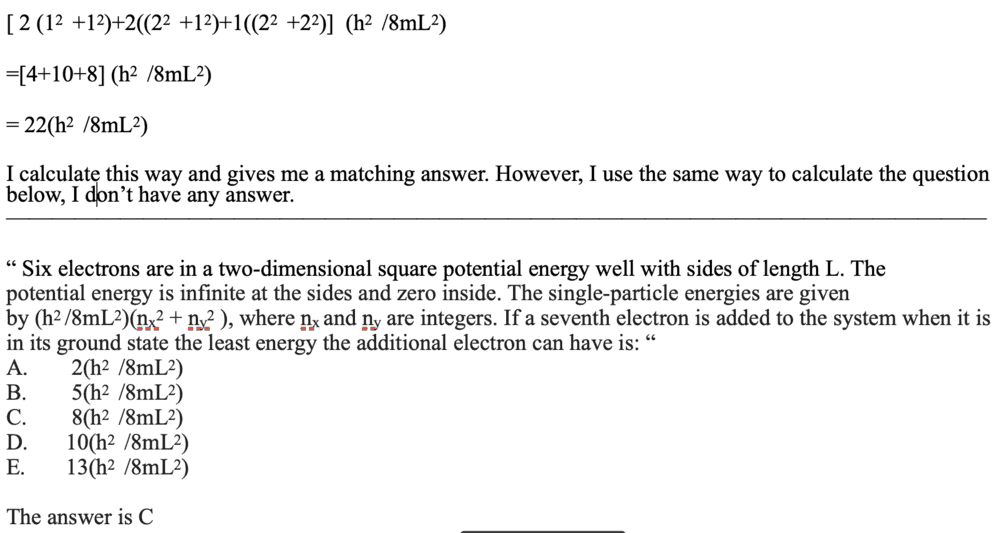

I calculate this way as per attached and gives me a matching answer. However, I use the same way to calculate the question below, I don’t have any answer.
What principles are you using to calculate these answers? You haven't said anything about why you are choosing these system configurations.
So it seems you have now answered the question in post #1, right? but can't see how to use the same principles on the question in the attachment in post #5.
Now, this is a subject about which I know next to nothing, yet I think I see how it works.
For the six in ground state, what do you think their energy levels are? What is the next available level?
Likes Steve4Physics and PeroK

I'll name the questions to avoid confusion:
Q1: the original 5-electron question in post #1;
Q2: the '7-th electron' question in post #5's attachment.
From your postings it is not clear (to me at least) if you have now understood and correctly answered both questions!
Note that Q1 asks for the total energy of the system in its 1st excited state. But Q2 asks for the energy of only the 7-th electron in its ground state. Q1 and Q2 want different things - but you find them in similar ways.
Do you know which (who's) principle you are using?
As an additional note, multi-electron systems - such as the ones in the questions - have potential energy due to the mutual repulsion of the electrons. But the expression ##(n_x^2+n_y^2)\frac{h^2}{8mL}## only applies to a single electron with zero potential energy inside the 'well'. So the question is flawed. But you are meant to ignore that.
EDIT: Typo' corrected.

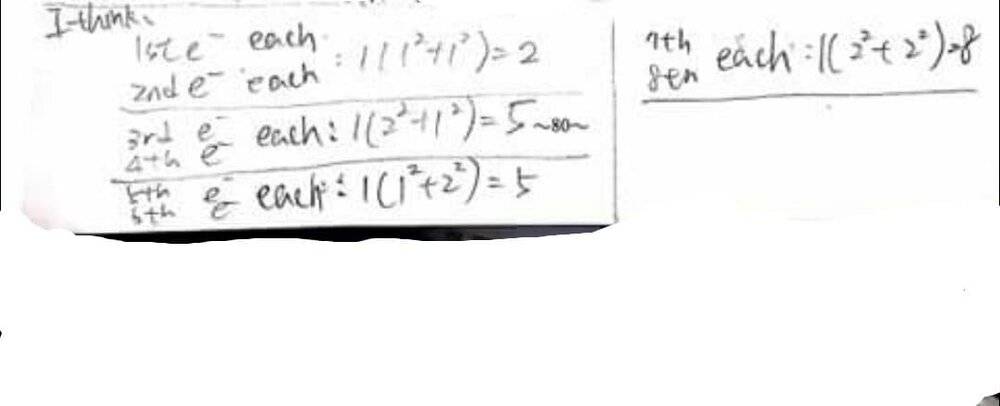

Thanks your comments. I'll look into it more.
hidemi said:
(Attachment in post #8)
Those numbers lead to answer C, as required: 7th & 8th, 8 each.
So, my thoughts written in the post #8 attachment are correct?
If so, I still don't quite understand the calculation behind it. Do you have a better explanation?
As I wrote, I have never studied the subject, so my understanding is based on this thread, and a vague understanding that electrons have no individuality.
No two electrons can be in the same state in the well, and such a state is defined by spin and an ordered pair (m,n) of natural numbers, spin being binary. The energy is characterized by the sum of squares of m, n.
So for the lowest total energy we fill in two with opposite spins at (1,1), two at (1,2), two at (2,1). After that it gets a bit trickier because you need to figure out that e.g. 22+22<12+32.
