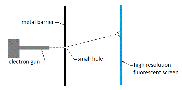

If we have a momentum measuring apparatus consisting of a metal plate with a hole, and the diameter of the hole is small in comparison to the size of an electron, then when the electron passes through the hole, we know exactly where it is. And later when it impacts the screen, we also know exactly where it is. By measuring the time it takes to travel from the hole to the screen, we should be able calculate the momentum of the electron to any arbitrary level of precision.
1. It cannot be done. The electrons in the metal plate are in extended states and will promptly fill the hole.
2. By trying to constrain the electron to such a small region in the transverse direction, you are only increasing the uncertainty in the transverse momentum
Correct, but I think increasing the uncertainty of momentum just means it is impossible to predict where the electron will land.
Quite right. It also means you don't know what the momentum is, and there is a probability that it turns out to be very high (or low), which means that there is a large uncertainty in energy.
Not exactly, only to the precision of the size of the hole. And the electron's momentum will become correspondingly uncertain--in other words, knowledge of what the electron's momentum was before it went through the hole will not let you predict where it will land on the screen; and the smaller the hole, the greater the uncertainty in where the electron will land on the screen, for a given momentum before it went through the hole.
Not exactly, only to the precision of the size of the spot that appears on the screen on impact.

PeterDonis said:
You can calculate the momentum the electron had from the hole to the screen, yes. But that doesn't help you predict the electron's momentum after it hits the screen from knowledge of its momentum before it hits the screen;
Please elaborate. After it hits the screen, its momentum is zero. Before it hits the screen, the momentum is uncertain. What am I missing?
No, it isn't. You aren't keeping track of the electron after it hits the screen, so you don't know what its momentum is.
Likes David Lewis
And if I understand it correctly you can also calculate the position of that electron. Precision limited only by your measuring technology.
From what? You can measure it directly, but if you didn't do that, how would you calculate it?
Right. "Calculate" isn't the appropriate term. You can pinpoint the position of the electron the moment it passes through the hole, and then when it hits the screen.
To the accuracy of the size of the hole, yes, as I said before.
To the accuracy of the size of the spot on the screen, yes.
But you aren't measuring the momentum in either one of these measurements. You can calculate a momentum for the electron between those two measurements, and the accuracy of that calculation is not limited by the uncertainty principle. But the momentum you get from that calculation tells you nothing about what the momentum of the electron will be after the second measurement--which is what the uncertainty principle limits the accuracy of predicting.
