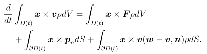

As an exercise I tried to determine the equation of angular momentum balance; I wondered if my working looks correct to you? The local equation of angular momentum balance is ##p^{ij} = p^{ji}##. Let\begin{align*}
\boldsymbol{L}(t) &= \int_{D(t)} \boldsymbol{r} \times \boldsymbol{v}(\boldsymbol{r},t) \rho(\boldsymbol{r},t) dV \\
L^i(t) &= \int_{D(t)} \epsilon_{ijk} x^j v^k \rho dV
\end{align*}and also let\begin{align*}
\boldsymbol{M}(t) &= \int_{D(t)} \boldsymbol{r} \times \boldsymbol{F}(\boldsymbol{r},t) \rho(\boldsymbol{r},t)dV \\
M^i(t) &= \int_{D(t)} \epsilon_{ijk} x^j F^k \rho dV
\end{align*}Take the time derivative of ##L^i##, using the local momentum balance equation as well as ##\epsilon_{ijk} v^j v^k = 0##,\begin{align*}
\dfrac{d}{dt} L^i &= \int_{D(t)} \epsilon_{ijk} \left( v^j v^k \rho + x^j v^k_t \rho + x^j v^k \rho_t + \mathrm{div}(\rho x^j v^k \boldsymbol{w}) \right) dV \\
&= \int_{D(t)} \epsilon_{ijk} \left( x^j \left[ \left( F^k-\frac{\partial v^k}{\partial x^l}v^l\right)\rho+\frac{\partial p^{kl}}{\partial x^l} \right] + x^j v^k \rho_t \right) dV \\
&\hspace{35pt} + \int_{D(t)} \epsilon_{ijk} \mathrm{div}(\rho x^j v^k \boldsymbol{w}) dV \\ \\
&= \int_{D(t)} \epsilon_{ijk} \left( - x^j \frac{\partial v^k}{\partial x^l}v^l \rho + x^j\frac{\partial p^{kl}}{\partial x^l} + x^j v^k \rho_t \right) dV + M^i \\
\end{align*}Using partial integration, and the relation ##\rho_t + \mathrm{div}(\rho \boldsymbol{v})= 0##, we may write\begin{align*}
\int_{D(t)} \epsilon_{ijk} x^j\frac{\partial v^k}{\partial x^l}v^l \rho dV - \int_{\partial D(t)} \epsilon_{ijk} x^j v^kv^l n_l\rho ds &=-\int_{D(t)} \epsilon_{ijk} v^k \dfrac{\partial}{\partial x^l} ( x^j v^l \rho)dV \\
&= -\int_{D(t)} \epsilon_{ijk} v^k (v^j \rho + x^j \mathrm{div}(\rho\boldsymbol{v}))dV \\
&= -\int_{D(t)} \epsilon_{ijk} x^j v^k \mathrm{div}(\rho\boldsymbol{v})dV \\
&= + \int_{D(t)} \epsilon_{ijk} x^j v^k \rho_t dV
\end{align*}as well as\begin{align*}
\int_{D(t)} \epsilon_{ijk} x^j \dfrac{\partial p^{kl}}{\partial x^l} dV &= \int_{\partial D(t)} \epsilon_{ijk} x^j p^{kl} n_l ds - \int_{D(t)} \epsilon_{ijk} p^{kj} dV \\
\end{align*}where in the final equality the symmetry of ##p^{ij} = p^{ji}## was used. The time derivative of ##L^i## can hence be rewritten as\begin{align*}
\int_{\partial D(t)} \epsilon_{ijk} x^j (p^{kl} - v^k v^l \rho) n_l ds + M^i \\
\end{align*}Does this equation look correct? It can probably be simplified further.
I think you just missed ##\rho## and the formulas must be as follows

Thanks! I missed out a ##\rho## when writing my final equation [it is now corrected]. Then\begin{align*}
&\hspace{35pt} + \int_{D(t)} \epsilon_{ijk} \mathrm{div}(\rho x^j v^k \boldsymbol{w}) dV \\ \\&=
\int_{\partial D(t)} \epsilon_{ijk} x^j p^{kl} n_l ds + M^i \\
&\hspace{35pt} + \int_{D(t)} \epsilon_{ijk} \rho x^j v^k (w^l - v^l) n_l ds
\end{align*}Multiplying by ##\boldsymbol{e}_i## yields\begin{align*}
\dfrac{d}{dt} \boldsymbol{L} = \int_{\partial D(t)} \boldsymbol{r} \times \boldsymbol{p}_n ds + \boldsymbol{M} + \int_{\partial D(t)} \boldsymbol{r} \times \boldsymbol{v} (\boldsymbol{w} - \boldsymbol{v}, \boldsymbol{n}) ds
\end{align*}where ##(\boldsymbol{p}_n)^i = p^{ij} n_j##.
