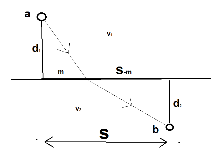

Hello,
Consider the next scenario:
I wish to travel from point a to point b as fast as possible. Between the points there is a border. In the region from a to the border, I can move only with velocity v1, and after the border, I am allowed to move only with velocity v2. All the additional details are given in the sketch:
As it turns out, the problem is not as easy as it appears to be because it is not clear where I should pass the border. If v1 is bigger than v2 then I should consider taking a longer route in the first section to compensate on the time spent in the second section. However, a longer route in the first section adds up to the overall distance.
My attempt to solve it was to express the overall duration of the route as a function of m and minimize it. To my dismay, I ended up with a fourth-degree equation that didn't want to crack...

There will be different answers on this depending on which v is faster and by how much. Have you given all the details on this?
I don't get at all why that should be an issue. The solution needs to be general and has to encompass both situations automatically. I agree that it's a nasty problem but not because you can't decide in advance which path should be longer. That's what you are supposed to be SOLVING for, really.
This is a standard problem in calculus textbooks, where the goal is to minimize the time rather than the distance covered. Typical problems include scenarios in which you need to get to a point on the other side of a river, and your velocity while swimming or boating is different from your velocity on foot, as well as finding the path of least time for light passing through two different media.

I get : m = v1 √(d1^2+m^2) / ( v2 √(d2^2+(S-m)^2) + v1 √(d1^2 + m^2) )
Yes, refraction and the principle of least time was the first thing that came to my mind (since the kind of diagram, as in OP, is often associated with it).
