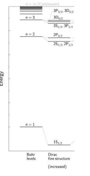

As for part b) I'm not entirely sure on how to proceed with it. Is it essentially asking that a diagram be sketched similar to the following:
The only difference really being that the states are to be labelled as ##^{2s+1}L_j##.
Yes, that's right.
