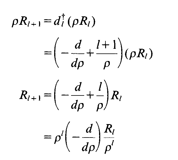

Hi!
I'm studying Shankar's Principle of quantum mechanics
I didn't get the last conclusion, can someone help me understand it, please. Where did the l over rho come from?
Expand the 2nd line. (And btw, if you still don't get it, show your attempt.)
Likes vanhees71 and Nugatory
