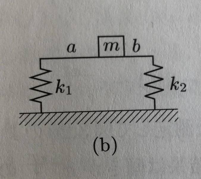

The frequency of two parallel springs and one weight system
In summary, the conversation discusses finding the angular frequency of a system using the equations F = -kx and U = 1/2*k*x^2. The student is struggling to understand the solution and the concept of moment of inertia. They also discuss using the sum of moments to solve the problem.
ltnghia1304
I want to find the angular frequency of the system below
F = -kx
U = 1/2*k*x^2
But here's the answer:
I don't know how come this solution. Any one help me? Thank you so much.
