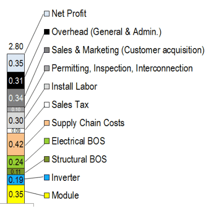

And the result is shown below (source: Fraunhofer agregator). If Germany is any guide, about 7 or 8% solar share of generation, without storage, is the economic limit, at least at that latitude. Perhaps lower latitude, clear sky areas can go a little further.
Edit: apparently not all government support for solar is gone. The surcharge remains, and has increased. Surely those funds find their way in part to solar owners.
