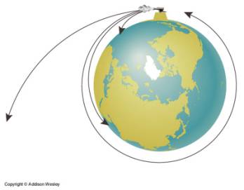

why didn't Earth's gravity pull the moon right to it's surface instead of keeping it in an orbit?
The moon falls (accelerates) toward the Earth at the same rate that an apple would fall if we could hold it stationary at that distance from the Earth and then let it go. The moon doesn't hit the Earth because it's also moving sideways, so it continuously keeps missing the earth. Likewise if you could shoot a cannon ball at the right speed and if there were no air resistance, it would orbit the earth.
could it be that the moon is falling through space but the Earth's gravity prevents it from doing so yet it is not strong enough to pull the moon into itself at that distance so gravity then makes it orbit instead?
That does not make sense at all. What does "falling through space" and "preventing it from doing so" even mean?

There's a very simple way of explaining it. An object moves through space in a straight line unless subjected to a force. Gravity, being a force, causes it to move in a curved line instead. If you do the math, you can figure out what the shape of the curved line is. For the Moon, the shape corresponds to an oval, with the Earth at one focus. Since an oval is a closed shape (compared to a parabola or a hyperbola, which aren't) this means that the Moon is in a closed orbit. If the shape of the line were a parabola or hyperbola then the orbit would be open, and the object would pass nearby and then head off into space and never return.
