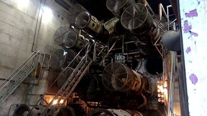

Here is a picture you may not find anywhere else. It is a 100MW gas turbine generator that went into operation in the early 60's. Only two were built. The other one was in France and has since been demolished. A large company that built jet engines, large turbine rotors and generators came up with idea. Alcohol may have been involved. So, 10 jet engines blow against a large fan and turn a generator. Only shown are 8 engines and it can run without two. This is a peaking generator and it was decommissioned for 15 years. When they tried to bring it back online everyone who knew how to run it was DEAD. Took two years to figure it out. Manager says many parts are only available on ebay as items are out of production for 30 years. They held off a scheduled startup for a couple weeks so I could see it run. Big clunking relays and sounds like the end of the world. I stood just in front of it as it ran if you can imagine the screaming of 8 jet engines. This is a historic design, yet the ASME history of gas turbine generators doesn't mention it. Noone else tried this. 70 years later it is still running.
One could argue,your anecdote isn't convincing. Empirical evidence is insufficient in a public forum.
Blah!blah!blah!
Often,what is TRUE...Cannot be proven!
You said [ Quote]"Haven't looked at it in probably 20 years and it is a thousand miles away from me right now. It is probably been out of print long enough that it may be a free download. History is defined by those who write it".
Agreed 100% . Can't find it on the interweb. Safe journey home.
