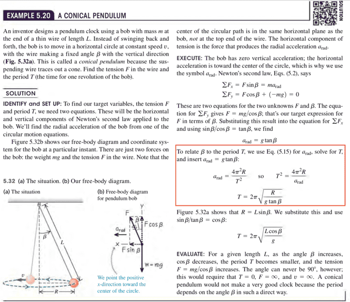

I cannot understand for the life of me why this problem doesn't just use T = 2πr/v to solve for the period to get T = 2π(Lsinβ)/v. Instead, it rearranges the formula for a(rad) = (4π^2R)/T^2 to solve for T, and arrives at a totally different answer, T = 2π√(Lcosβ/g).
So why doesn't the formula T = 2πr/v apply in this case?

The formula applies but the solution is cast in terms of angle ##\beta## instead of the speed. That's because you need to measure both ##R## and ##v## to find the period. It is more practical to find the period by measuring angle ##\beta## and the unchanging length ##L##..

Thank you, but it still doesn't seem like T = 2π(Lsinβ)/v and T = 2π√(Lcosβ/g) would equate. It seems like they would give different values for the period

How do you know? What is ##v## in your estimation? Note that it depends on ##\beta##. For example, if ##\beta=0## then ##v=0## because the conical pendulum will be hanging vertically. Can you relate ##v## to ##\beta##? Replacing ##v## and ##R## with expressions that depend on ##\beta## in ##T=\frac{2\pi R}{v}## should convince you that the two ways of writing the period are equivalent.
