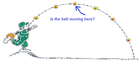

One side if the roof of a house slopes up at 37.0°.A roofer kicks a round,flat rock that has been thrown onto the roof by a neighborhood child.The rock slides straight up the incline with an initial speed of 15ms-1.The coefficient of kinetic friction between the rock and the roof is 0.400.The rock slides 10.0m up the rock and the roof crosses the ridge and goes into free fall, following a parabolic trajectory above the far side of the roof,with negligible air resistance.Determine the maximum height the rock reaches above the point where it was kicked.
Are there anything wrong?
Let the maximum height the rock reaches above the point where it was kicked be h.
1/2mv2=mgh+fs
1/2m(15)2=9.8mh+0.4xmx9.8xcos37°x10

1/2mv2=mgh+fs
Does the rock have any kinetic energy when it reaches maximum height?
I think...no.
This is because all the energy will convert to potential energy.
haha1234 said:
I think...no.
What would happen to the rock (which is traveling along a parabolic arc) if it came to rest at its highest point?
Thanks!I can find the correct answer now!
