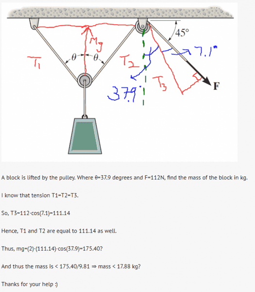

A block is lifted by the pulley. Where θ=37.9 degrees and F=112N, find the mass of the block in kg.
I know that tension T1=T2=T3.
So, T3=112⋅cos(7.1)=111.14
Hence, T1 and T2 are equal to 111.14 as well.
Thus, mg=(2)⋅(111.14)⋅cos(37.9)=175.40?
And thus the mass is < 175.40/9.81 ⇒ mass < 17.88 kg?
Thanks for your help :)

What does the 7.1 degree angle have to do with anything?

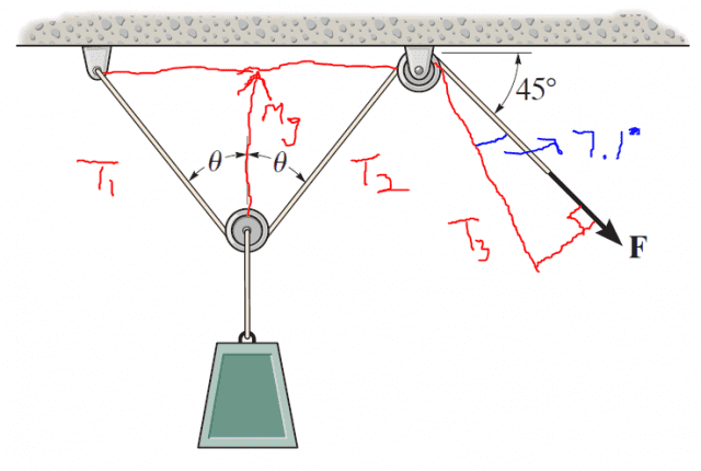

Wouldn't T3 have to be at the same angle as T1 and T2?

No. Any particular reason why you think so?

Oh, does the angle not determine how much force is required to lift the block?

No. Again, why do you think it would?
Now, the angle ##\theta## will influence the force. I suggest you draw a free body diagram for the mass.

So mg is equal to (2)(112)cos(37.9)?
Yes. For the future, please state your reasoning more clearly. It will make it easier to help you. It will also generally help if you answer direct questions.
