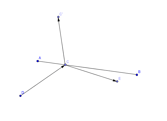

How does pushing air upwards through a rotor that's rotating to push air downwards speed it up? Pushing air upwards pushes on the underside of the blades and thus against the spin.
Vectors. Take a look at this picture.
Segment from A to B is your wing/blade chord with positive angle of attack. C is center of pressure. Vector DC is the momentum of incoming air. Vector CE is momentum of outgoing air. As you can see, air was pushed down. The difference of two vectors, DC-CE=CC' is the amount of momentum transferred to the wing/blade. Momentum transferred per unit time is the force. So the force on the wing/blade will be in direction of CC'. As you can see, it is mostly upward, but that vector is also slanted slightly forward, so it will be pushing the wing/blade forward, rather than slowing it down.
I understand that it seems slightly counter-intuitive, but this is how airfoils work.
P.S. The actual angle of attack here is the angle DCA, which is way too high for a real wing. I had to exaggerate things a little to be more clear.
From what I understand, it's the air pushing backwards (while the gyrocopter moves forwards) that generates the torque that drives the rotor (auto-gyro), which in turns generates lift. A gyrocopter can't hover, it always needs some amount of forward speed. If the engine goes out, a gyrocopter can glide, something like a 3:1 or 4:1 glide ratio (maybe higher, these are just the numbers I recall).
So basically, you're saying that the angle the air comes off the wing is less than the angle it comes on, by more than the pitch angle? I suppose I can accept that (it's converting the kinetic energy of the air into its own KE, yes?)... but it depends on forward speed to generate the large DC, yes (and on rotor speed to make it come from the right direction)?

No. Airfoil pushes the air downwards. That's all it really does. The rest is about angle of attack and relative wind. Because relative wind comes from bellow, there is forward component to generated lift. That's what spins the rotor.
The 4:1 glide ratio for autorotation is the maximum. You can go down steeper. Reason you usually don't want to is because with a glide you get more clean air in your rotors, and if you stall the rotor in autorotation, you are kind of screwed. Of course, the rotor on autogyro is tilted, which makes proposition of vertical descent without power even trickier. But the rotor itself, without significant load, can autorotate vertically down. Horizontal speed is not necessary.
magic9mushroo said:
So basically, you're saying that the angle the air comes off the wing is less than the angle it comes on, by more than the angle of attack? I suppose I can accept that (it's converting the kinetic energy of the air into its own KE, yes?)... but it depends on forward speed to generate the large DC, yes (and on rotor speed to make it come from the right direction)?
Pretty much. It's a little more complicated with energy. The way I've drawn it, the energy of the flow is conserved, but yes, realistically, it decreases. Part of it can go into any work that needs to be done on the rotor. The rest of it goes into turbulence.
