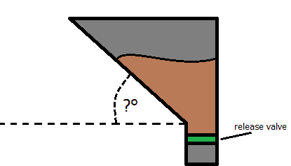

In summary, an IT student is working on a project to automate the dispensing of grains on a given schedule. The system uses Arduino to dispense servings of grains. The problem is figuring out what the minimum angle the side of the container should incline at so that the grains slide down easily. The system also needs to be able to hold a maximum of 5 kg of grains and the container needs to be completely empty once all the servings of grain have been dispensed. The system also needs to be able to adjust the inclination and height of the whole system based on whatever needed.
Quill
I am an IT student and working on a project, an automated system. It's not for a physics class. I can't say exactly what the system can do. But it uses Arduino to dispense servings of grains on a given schedule. I am more of a programmer than a physicist, I am looking for help on this.
1. Homework Statement
The problem is knowing what the minimum angle the side of the container should incline at, so that the grains will be able to slide down through a tube using gravity. Let's say that an individual grain ranges from 4-7 mm and weighs about 0.028 g. The container will be able to hold up to 5 kg of these grains. One serving will contain around 340 g of grains. The container needs to be completely empty once all the servings of grain has been dispensed, which can take about half or more of a month. That is about 14-15 servings.
What makes this more difficult is that the grains aren't one whole solid object. There will be thousands of grains inside the container. So when the container reaches nearly empty, It'll be difficult knowing how much of an angle (at a minimum) the surface needs to be inclined at to let the few amounts of grain that are left to slide easily without the added weight of the other grains.

I am not good at physics. But from researching, this might be a relevant equation:
X = sin^-1 (ax / g)
ax = acceleration on x-axis
g = gravity
I need help with this. I am not even sure if I got the correct equation for my problem.
Also, the reason I am looking for the minimum angle is to help figure out how much space I can work with for other objects that I might put under the container. So I can adjust the inclination based on the minimum for how much space I might need. And also to help adjust the height of the whole system based on whatever needed.

I assume your algorithm will hold the gate open for a fixed time, so one issue may be having the grains flow at the same rate at each serving. Fortunately, grains do not behave quite like a fluid.
Conversely, grains are apt to jam in the aperture.
I don't think theoretical physics is going to help much. It will take trial and error, using the specific grain in question. Even humidity may affect it.
I was planning on making the tube that holds the released grains a certain size, as in the tube will hold 1 serving. So the container will release the grains into a tube that is already 1 serving size. When the container dispenses, the serving size tube at the end will stop the flow. I'll test how long it takes for the tube to fill up, and use that to adjust the algorithm for how long it should keep the gate open.
True, I've been trying to find/think of a design that can prevent that.By the way, I haven't yet created the system. Right now I am designing the blueprint before implementation. Anyways, thanks! :biggrin:
Won't that create a problem closing the valve?
The pet feeders I've seen have used a paddle wheel arrangement at the bottom of the chute. It serves as both metering agent and valve. As the wheel turns it moves a fixed quantity to the exit while the backside of the paddles serve to block the passage from more pellets. I've not seen them in cross section, but I imagine such a section might look something like this:
Edit: Oh, I should mention that the paddles were made of a flexible plastic material so that pellets cannot jam the rotation by getting wedged.
Can't put my finger on why, but intuitively I expected the rotation to be the other way.
Likes gneill
I think that you may be right. Perhaps it's less likely for a jam to occur against a smooth surface transition. I drew the diagram from a "static" memory of what I saw looking down into the maw of the hopper, I didn't view it in operation. I believe that your intuition is correct. Thanks.
