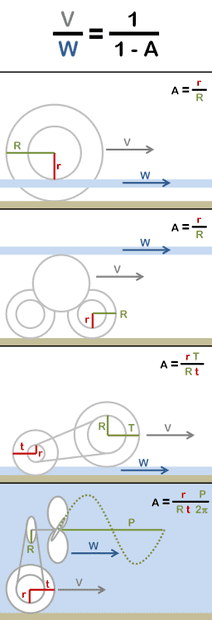

"But how can an vehicle move faster than the wind that is powering it?"
- The same way that the wheel of a car can rotate faster than the engine drive shaft is rotating; by using leverage via gearbox, or via propeller. I saw someone in this forum has made a perfect example already with nothing but legos: - if you think that analogy is not valid to demonstrate that the speed of a power source is not the same thing as the power of it, then you have something upside down in your own intuition, and I suggest first reading up on how an ordinary pulley can convert force into larger force without breaking the laws of physics.
"But it's not possible to get more speed out of the wind by driving it through a wheel"
- It is possible to get more power out of the wind than a simple sail does, by having a way to leverage the momentum of the wind with a propeller. With larger propeller and larger rotation speeds you are simply leveraging more air mass than a sail. It's nothing more fancy than that.

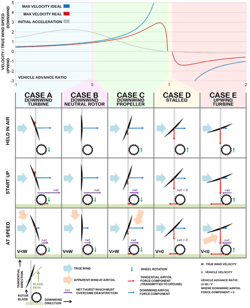

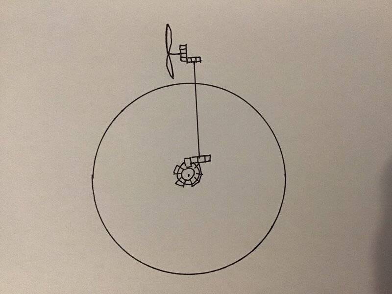

I think what intrigued me about this is that I often think when the wind hit a windmill, the blade turn with the wind. It baffles me when the blade turns the opposite of the wind. So here I drew up a system of how we can make the blade turn any direction.
we have blades and a large wheel. When the wind hit the blades, the blades wants to turn with the wind, however, the large wheel anchored to the ground produce a large torque. The torque transmit through gears to turn the blades in any direction desired. There we have it.
Likes AnssiH and A.T.
leafy said:
When the wind hit the blades, the blades wants to turn with the wind, however, the large wheel anchored to the ground produce a large torque. The torque transmit through gears to turn the blades in any direction desired. There we have it.View attachment 293825
Yes, considering extreme cases often helps, and your huge wheel makes it obvious.
Alternatively you can consider what happens when you change the pitch of the rotor blades, as this directly controls how much downwind force vs. torque they produce. All the possible cases are in the table below. For downwind faster than the wind you need CASE C, which spins opposite with wheels on the ground, than it would when held in air, off the ground.
This animation can help to make sense of the diagram above:

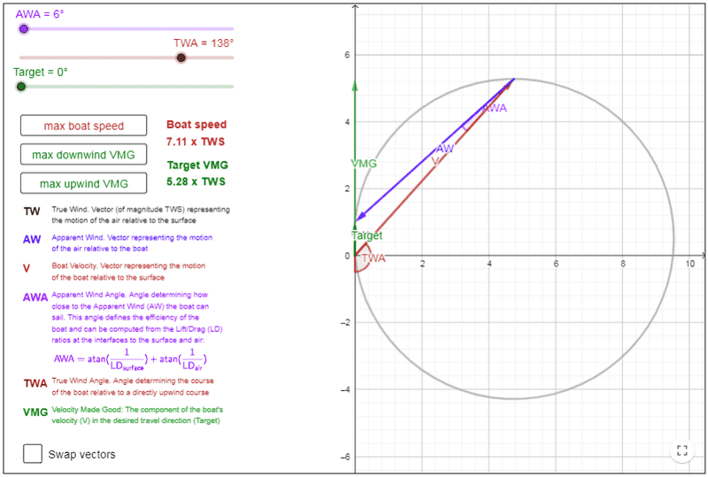

So I have a hypothetical land yacht with a pylon and two blade rotor. The blades and the ground wheels have generator / motors, connected by a reversible, infinitely variable ratio, converter / gearbox.
Given a flat area with a specified steady wind, I select two points, a starting point and a destination.
I need an algorithm that will solve;
What path between the points gives the minimum travel time ?
How should I configure the rotor and gearbox ratio ?
How do I transition to, then accelerate on, a new leg of the course ?
