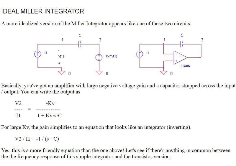

attached is a screenshot showing a schematic of an ideal miller integrator. Can anyone describe how the formula for V2/II is arrived at, can't work it out thru nodal analysis myself. Thanks in advance.

it's how you get to the equation V2/II= -K/(1+KSC) where I'm confused.
Analysis gives II = V/R1 + (V1 - V2),S,C where V is the voltage over R1.
Also V2 = V1.K.
In order to get the right equation from the above I'd have to eliminate R1 which I cant.

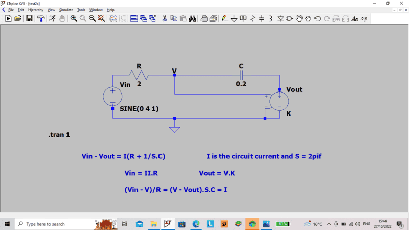

Attached is the ltspice schematic as per the netlist. I think it will be easier understanding if II is replaced by say SINE (0 1 1000).
OK thanks. Yes, or you can just leave it as an independent variable ##Il##.
Do you know about Thevenin/Norton transformations for sources yet? That would be my next step. But, if not, that's OK too.
So, this is just a network solution like the others you've done in the past. Define all of the stuff you need to make your node and loop equations (all of the currents and node voltages). Write them all down, loops of voltages for KVL, nodes with currents for KCL and show us that. After that you'll simplify/solve a set of equations.
The schematic you show in post #9 (your simulation) does not represent the schematic in post #1.
Please pay attention to the feedback polarity, one of them shows Positive feedback, the other shows Negative feedback.

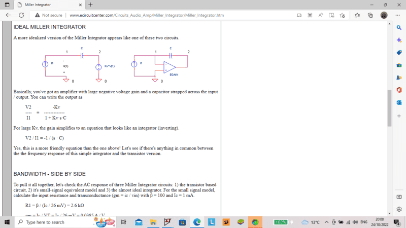

Be skeptical of things you find online because they could be wrong
like this example http://www.ecircuitcenter.com/Circuits_Audio_Amp/Miller_Integrator/Miller_Integrator.htm
$$\text{If}~~~~\frac {V_2}{I}=\frac {-k}{1+ksc} ~~~~~~~~~~~\text{then}~~~V_2=-kI~~~~~~\text{when}~~c=0 $$
$$\text{But for this circuit, this conclusion is obviously not valid}$$
