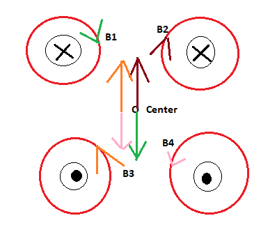

Four, long, parallel power lines each carry 100-A currents. A cross-sectional diagram of these lines is a square, 20.0 cm on each side. For each of the three cases shown in , calculate the magnetic field at the center of the square.
##B = \frac {\mu_0 I} {2a}##
The current direction is as follows
I think so much and do the right hand rule i get 0 at the center, but not sure why the answer is non zero. I have shown the directions of the magnetic fields, i have not shown the magnitudes of equal length but they all are equal. Why the answer is non zero, what mistake i am doing?

The first two I could solve, this is the 3rd one which I am struggling to get answer.
May I suggest drawing the arrows again?
I end up getting below the same,
No, try again.

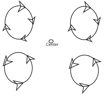

Gordianus said:
No, try again.
Ok, chances are there of a below diagram
But a very tough one to know where it will be left. Am i correct here?
Try drawing the B-lines of each wire
The B lines are like this
Everything seems to be left.

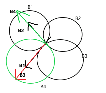

Good! Now extend the lines to the center and draw the arrows again.
Likes hutchphd
Surely the tougher than i expected. Hope it is correct.
Victory!
Likes PhysicsTest
Thank you very much for support.
