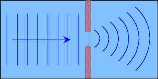

Let's say that we're sending a collimated beam of EM radiation through a slit that's 3 cm wide, and it diffracts and forms a clear interference pattern on a screen, with the bands of brightness and darkness, or of high and low intensities.
And next, we reduce the intensity of the beam until it emits only one photon at a time. Let's say one photon every two seconds.
If we obtain the collective results of multiple photons' landing positions on the screen, what will the resulting pattern look like?
And let's say we make it a double-slit experimental set-up, and the distance between the two slits is 5 cm, they are spaced 5 cm apart, I'm also wondering what the resulting pattern will look like.

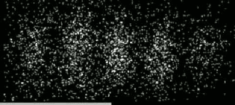

The same as the pattern you saw at high intensity.

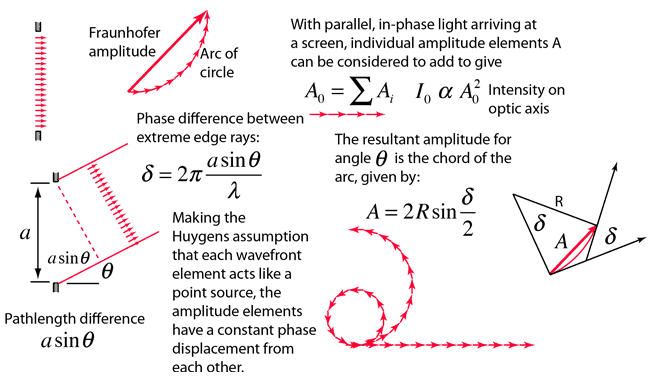

do you mean like the summing up of all the phases forming a "circular arc"
http://hyperphysics.phy-astr.gsu.edu/hbase/phyopt/sinint.html#c3
"Divided into segments, each of which can be regarded as a point source, the amplitudes of the segments will have a constant phase displacement from each other, and will form segments of a circular arc when added as vectors."
For single slit diffraction, yes. This is because you have to take into account the finite width of the slit in order to get an interference pattern with a single slit.
For the double slit case, the usual analysis does not get this complicated, because you don't need to take into account the finite width of the slits. All you need is the distance between the slits. The phase at each point on the detector is just the sum of two phases, one from each slit, each one depending on the path length from that slit to the given point on the detector. That is enough to get the double slit interference pattern.
A more complicated analysis of the double slit case would involve adding together two single slit patterns of the kind shown in the article you reference. This is not usually done because diffraction effects from each slit individually are usually negligible in a double slit experiment.

Now if you use a single-photon source and observe the single photons one by one hitting the screen, you'll see that each photon will indeed leave only one spot on the screen, i.e., the single photon is not observed as somehow "smeared" as a classical em. wave (quantum-field theoretical it's a socalled coherent state, which is a state of the em. field that has not a specified photon number). For each single photon you cannot predict, where it will hit the screen behind the double slit but if you wait long enough to collect very many photons, you'll find the same interference pattern as with a classical em. wave. This means that the intensity of the classical em. wave translates into the detection probability distribution of the single photon on the screen, where each single photon is "prepared" to have the same properties (i.e., pretty well defined wave vector or using the Einstein-de Broglie relation, momentum ##\vec{p}=\hbar \vec{k}##).
In this way modern QFT delivers a consistent description what in the old quantum theory was called "wave-particle dualism": On the one hand you have "particle properties" of single photons: It's detected always only at one spot on the screen. On the other hand you have "wave properties" of an ensemble of equally prepared single photons: The pattern found after collecting very many such photons on the screen is given by the interference pattern of the classical em. wave, but the meaning of the corresponding intensity is a probability distribution for the detection of the single photon at any place of the screen.
