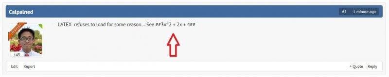

Latex refuses to load for some reason... Any solutions? Thanks everyone.
