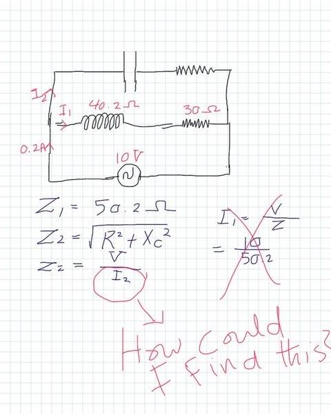

What you've described is one method: Add a series capacitor and resistor. Your calculations determine the values of the two components that must be added in series.
A second method would be to add a new branch in parallel with the original resistor and inductor.

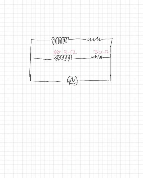

No, it doesn't, but do you mean something like this:
What would be the values of the new resistance and inductor, would they be the same as the original ones?
Not quite. Adding another inductor wouldn't correct the phase shift. The new branch would be a resistor and capacitor.

I don't know how to deal with circuits having capacitors and inductors in series, that's not in my course. So, some hints would be much appretiated?
In the second approach, a series R-L branch is in parallel with a series R-C branch.
But firstly, can you write the individual impedances of the two branches in complex form?

I did this, and I don't know what to do then:
And excuse me, what do you mean by "complex form"?
