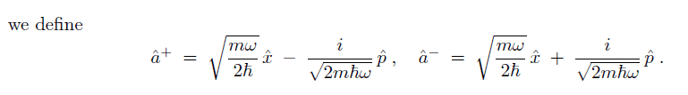

Thank you. I want to deduce the ladder operators based on physical reasons, not a mathematical skill and definition like this:
I'm not aware of a more "physical" way of finding out what these operators are.
You know, it is often like that in physics. Clever people play around with the maths, and figure out things that were unexpected. I don't know if some ever sat down with the intention of figuring out "What is the operator that will take any eigenfunction of the harmonic oscillator and give back the next higher eigenfunction?", compared to someone just realizing, "Hey, look at what this operator I found by playing around with the algebra does!"

Yeah, many historical events prove your viewpoint, such as Dirac equation, positron. But more important thing is that we should understand it more deeply and find more simpliy deduction, rather than such mathematical skills.
