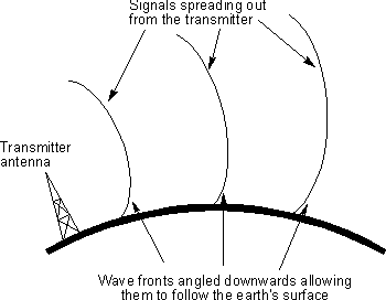

An example of 'bending' rays where wavelengths are bigger than a house, is in the mechanism of Medium Frequency Ground Wave Propagation. The loss in the ground (not a perfect conductor) produces a lag in the wavefront at ground level and will keep 'pulling' the radiated Power (the "rays") down towards the ground and so it follows the curvature of the Earth. There would still be propagation with a perfectly conducting Earth but the rate of drop off with distance would be higher. This tilting downwards of the wave front can be dramatic in the 'signal shadow' of a large town, in which the signal absorption is high. A few km beyond the town, the signal strength rises again as Power is angled downwards to the ground and the shadow is filled in again.
