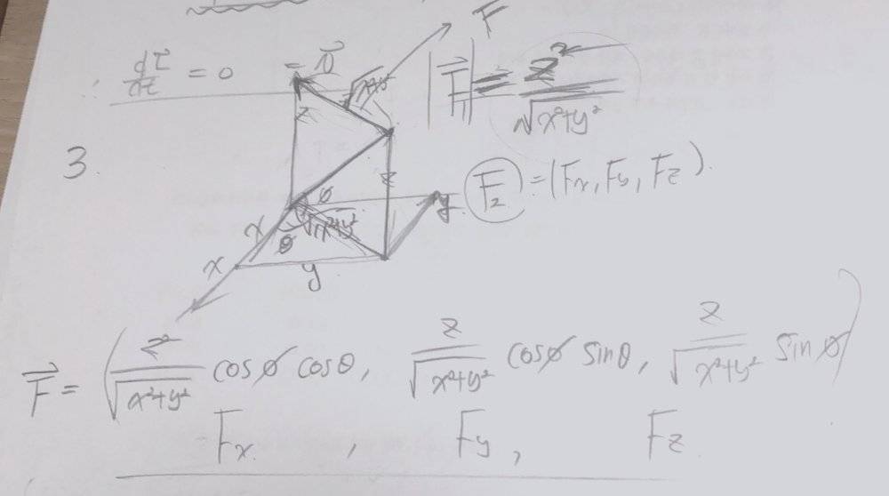

A particle is attracted toward the z-axis by a force F vector proportional to the square of its distance from the xy-plane and inversely proportional to its distance from the z-axis. Add an additional force perpendicular to F vector in such a way to make the total force conservative, and find the potential energy.
F = ∇ V, and a conservative force F satisfies ∇ X F = 0
I set the location of the particle (x,y,z); therefore,
the force F_1 is (z^2/root(x^2+y^2) * x/root(x^2+y^2) , z^2/root(x^2+y^2) * y/root(x^2+y^2), 0), since cosΘ is x/root(x^2+y^2).
