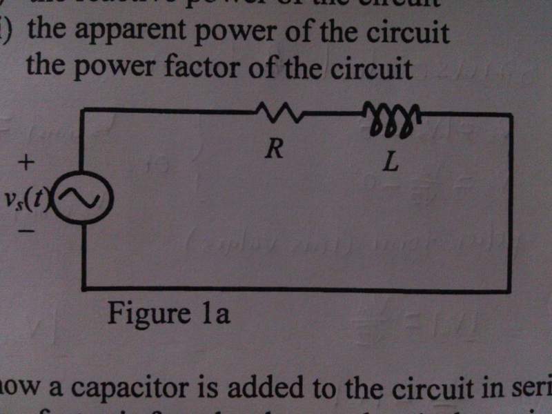

R = 100Ω, L=0.5H, supply voltage vs(t) = 12sin(377t) in Figure 1a
XL = wL =377(0.5) = 188.5Ω
vrms = 8.485∠0
Z=213.38∠62.05 Ω
I = 8.485∠0/ 213.38∠62.05 = 0.0398∠-62.05 A
VR = 3.98∠-62.05 V
VL = 7.502∠27.95 V
PT = 0.03982(100) = 0.158W
QT = QL = 0.299 VAR
ST = 0.338∠62.05 VA

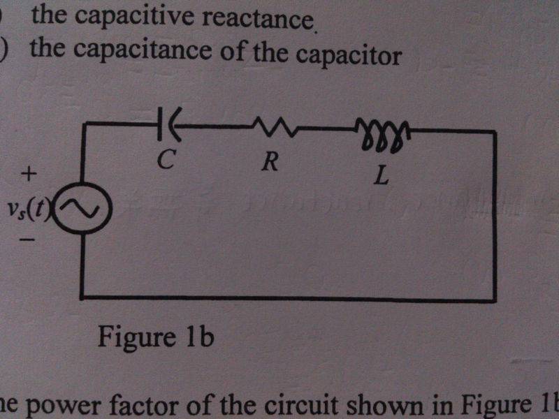

Fp = 0.467a capacitor is added to the circuit in series in figure 1b, and Fp = 1
S=0.158∠0
Q=0
PT=0.0346W
I=0.0186A
Z=455.7Ω
C=14.1μF
If Fp in figure 1b is equal to 0.8
Q=0.02595VAR(ind)
I=0.0051∠36.87 A
Z=1662.82∠-36.87 Ω

Your calculations for the required capacitor in Figure (a) appear to be fine.
For Figure (b), what are the given component values and conditions? Are the voltage source, resistance, and inductance the same as before?
Yes, They are same as before, and then step and step add the capacitor in the circuit and change the power factor from 1 to 0.8.
Thanks
Thanks
Just to be clear, the components start out as Vs, R, L, and C from part (a) where the power factor is 1, and you wish to add another capacitor to bring the power factor down to 0.8?

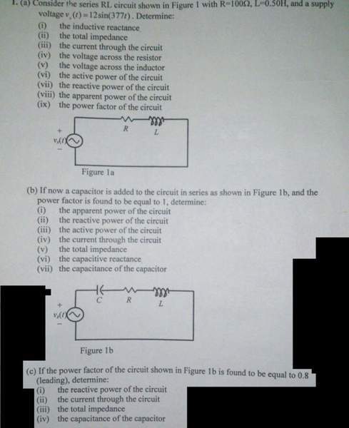

The complete question is uploaded in the file.
Thanks a lot.
Okay. Having the complete question helps.
For part (c)(iv), finding the capacitance, if you know the power factor and the resistance (the real part of the impedance), then you should be able to find the corresponding reactance. After all,
$$ pf = cos(\theta) = \frac{R}{\sqrt{R^2 + X^2}}$$
X will be positive or negative depending upon whether the current is said to be lagging or leading. You can then find XC from X = XL + XC.
