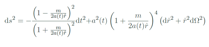

PAllen said:
Poking around a bit, it seems that the key thing to search for is the McVittie metric, which is an exact solution for a mass point embedded in an FLRW cosmology. Here are two example references:
https://arxiv.org/abs/1508.04763
https://iopscience.iop.org/article/10.1088/1742-6596/484/1/012044/pdf

I don’t understand. My link is to: ”Lensing in the McVittie metric”, from 2015. There is a brief mention of the pioneer anomaly, but that is tangential to the paper’s topic. The paper discusses the background of using the McVittie metric to analyze small scale effects of expansion. Its specific focus on lensing is not relevant, but the purpose of referencing it was to answer my own point that you need a way to combine Scwarzschild metric with FLRW metric to answer the questions you pose. After a little research, I found the McVittie metric is exactly such a proposal. This paper presents the McVittie metric with background and many references, thus perfectly on point from this point of view.
Note that the McVittie metric uses isotropic coordinates, so the form of the Schwarzschild metric it is implicitly using is different from the form I used in the post in another thread that @Buzz Bloom linked to and that I was discussing in my previous post. For large distances from a given mass, the difference in radial coordinates between isotropic and Schwarzschild coordinates is negligible, and both are well approximated by the actual proper distance ##D##, so this doesn't significantly affect what I posted, but it's worth being aware of.
Likes Buzz Bloom and PAllen
Btw, another implication of this is that describing the McVittie metric as a "mass point" embedded in an FRW universe is not quite correct. The metric does not cover the spacetime region at or below the event horizon of the mass at all (it can't since isotropic coordinates do not cover that region). So it is better described as a metric for the exterior of a black hole embedded in an FRW universe.

This would be a simpler alternative (or more precisely, one I happen to be familiar with) to using the McVitte metric
The McVittie metric is a generalization of the Schwarzschild-de Sitter metric that allows the perfect fluid that is filling the universe (apart from the "mass" in the center) to be something other than pure dark energy. Basically, you can plug in any equation of state that is compatible with an FRW spacetime.
As far as the approach you are taking to the OP question (which is basically the same as what I briefly described in post #26), it will work just fine in a general McVittie metric; you just need to write the metric in Schwarzschild coordinates (instead of the isotropic coordinates it is more often written in).
