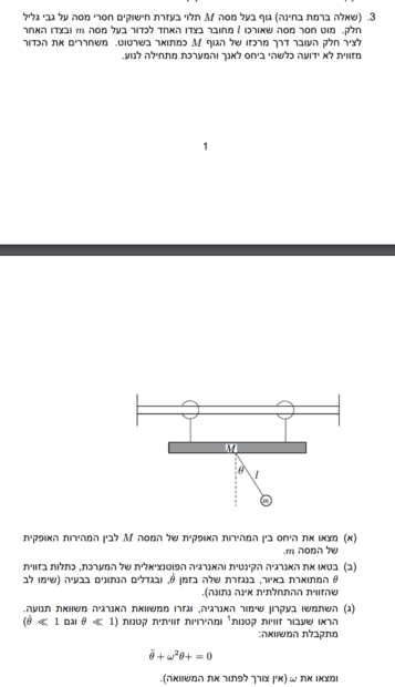

The ratio between two horizontal speeds in this pendulum arrangement

To find the ratio between the horizontal speed of the stick with mass ##M## and the small point with mass ##m##.
Force equation and torque.
From the forces equation I can only understand from it that the forces' equations are:##N=Mg## and ##T\sin \theta=m\ell \ddot{\theta}##.
But I don't know how to find the Torques' equations.
Any help is appreciated.
N=Mg ##Tcos⁡θ+N=mg
Could you please type out the text from your attachment, and explain that setup? Thanks.
