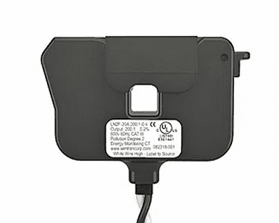

And there are Current Transformers for measuring AC currents (they generally are connected to a "burden resistor" and a voltmeter device for readout, or connected a an ammeter if there is no burden resistor):
https://i1.wp.com/sentrancorp.com/wp-content/uploads/2019/03/LN2F-Front.62.jpg?fit=404%2C323
