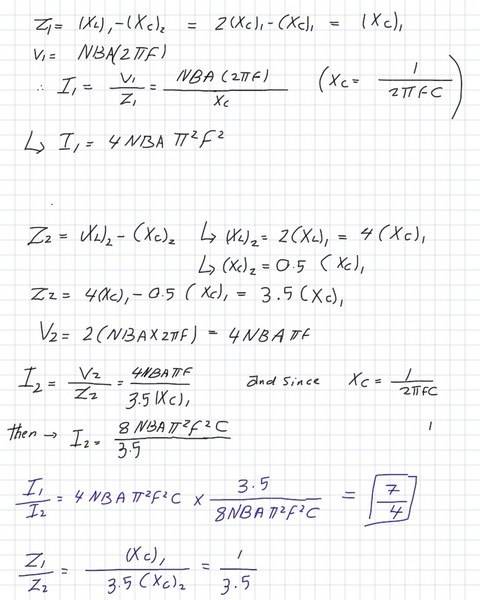

An AC source was connected to a capacitor and an inductor (ignoring its ohmic resistance) in series. If the inductive reactance was equal to twice the capacitive reactance, and then the frequency duplicated, determine:
1. the relationship between the the current before and after duplication of frequency. (i₁/i₂)
2. The relationship between the impedance of the circuit before and after duplication of frequency. (Z₁/Z₂)
i=V/Z
Xc=1/2πfC
V=NBAω
Note: In my solution I considered the maximum values of both the current and the voltage, is this correct?
Is my solution correct?
Where does your V1 come from? The problem statement doesn't say anything about a coil rotating in a magnetic field, and certainly the constants A and N are not given. It only says that there is an AC source. An for your determination of I1 you've only considered the capacitive reactance. Why is that?
You can assume that the AC source is an ideal voltage source with a fixed amplitude. Only the frequency of the source changes.

The statement doesn't mention that the AC source will change the amplitude of voltage as the frecuency changes. Are you assuming that or is missing in the statement?. Anyway when you calculate current why did you use only the Xc and not the series impedance?
Edit. Sorry I see that your using the xc as impedance because is the result of 2xc-xc. That is correct.

Gneil, in the problem statement it says :"the inductive reactance is twice the capacitive reactance" so Xl=2Xc, and when determining the equivalent impedance of both the capacitive reactance and the inductive reactance, I did this:
Z=Xl-Xc=2Xc-Xc=Xc
so the impedance of the circuit in the first case equals the capacitive reactance, doesn't it?

Yes, it didn't say anything about it, but I am assuming it, because in my physics assignment in general this year, all the AC sources are considered to be Dynamos, and since it didn't mention that the A and N will vary I assumed that they are constant.
I see. Well, that's an approach I've not seen before. So your source voltage is going to double when its frequency doubles. That will have an effect on the current.

I agree with gneill about the voltage source i think you should use the same amplitude V in both cases only the Xc and Xl will chanche with the frecuency. For me the rest of your approach is correct.

If you say that the AC source is a dynamo then taking into account the behavior of a dynamo is justified. But to me there is no evidence in the problem statement itself that a dynamo is implied. I've never seen a course where "AC source" must be interpreted as a dynamo by default. What I've seen is that when dynamos are being dealt with in a problem it is always explicitly stated.
Most often we treat AC sources like signal generators where voltage and frequency are both adjustable as desired, and changing one does not change the other.

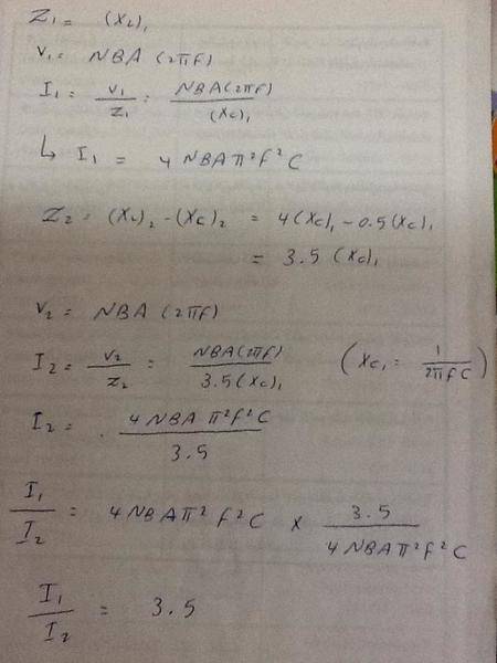

Anyway, let's say your point of view is the correct one, would the solution be like this (correcting some missing things and incorrect mathematical calculations):
Sure. Only I'd probably disregard the dynamo details entirely and just assume that the voltage was "V" for both cases, form the ratio and cancel it out early on:
##\frac{I_1}{I_2} = \left( \frac{V_1}{Z_1} \right) \cdot \left( \frac{Z_2}{V_2} \right) = \frac{Z_2}{Z_1}~~~~## since ##V_1 = V_2##
Then go ahead and work with the known details about the impedances.

OK, and that's what I got. In the solution attached in #1, in the final step I had Z1/Z2 = 1/3.5.
And then In the solution attached in #13, I had I1/I2 = 3.5, which equals Z2/Z1.
That means my solution is correct, right?
It means that you got the impedance ratio correct, yes. Whether or not you need to account for a "dynamo factor" I leave up to you :smile:
