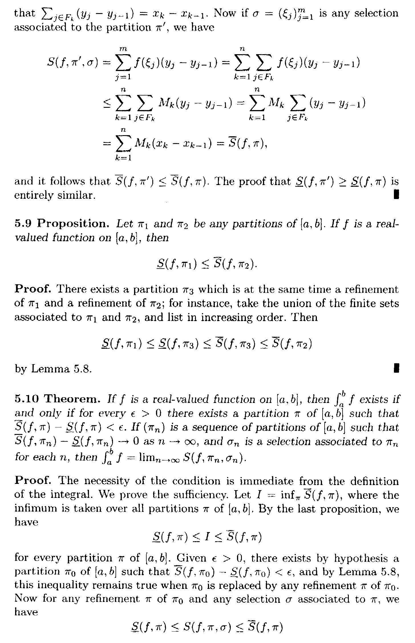

I am reading Andrew Browder's book: "Mathematical Analysis: An Introduction" ... ...
I am currently reading Chapter 5: The Riemann Integral and am currently focused on Section 5.1 Riemann Sums ... ...

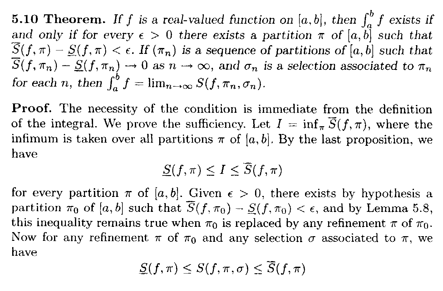

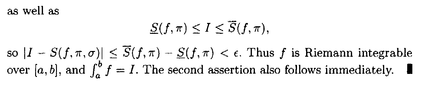

I need some help in understanding the proof of Theorem 5.10 ...Theorem 5.10 and its proof read as follows:View attachment 9473
At the start of the above proof by Browder we read the following:
" ... ... The necessity of the condition is immediate from the definition of the integral ... ... "Can someone please help me to rigorously demonstrate the necessity of the condition ...
Note: I am assuming that proving "the necessity of the condition is proving the following:$$\int_a^b f \text{ exists } \Longrightarrow$$ ... for every $$\epsilon \gt 0 \ \exists \ $$ a partition $$\pi$$ of $$[a, b]$$ such that $$\overline{S} (f, \pi) - \underline{S} (f, \pi) \lt \epsilon$$ ... ...
Help will be much appreciated ...

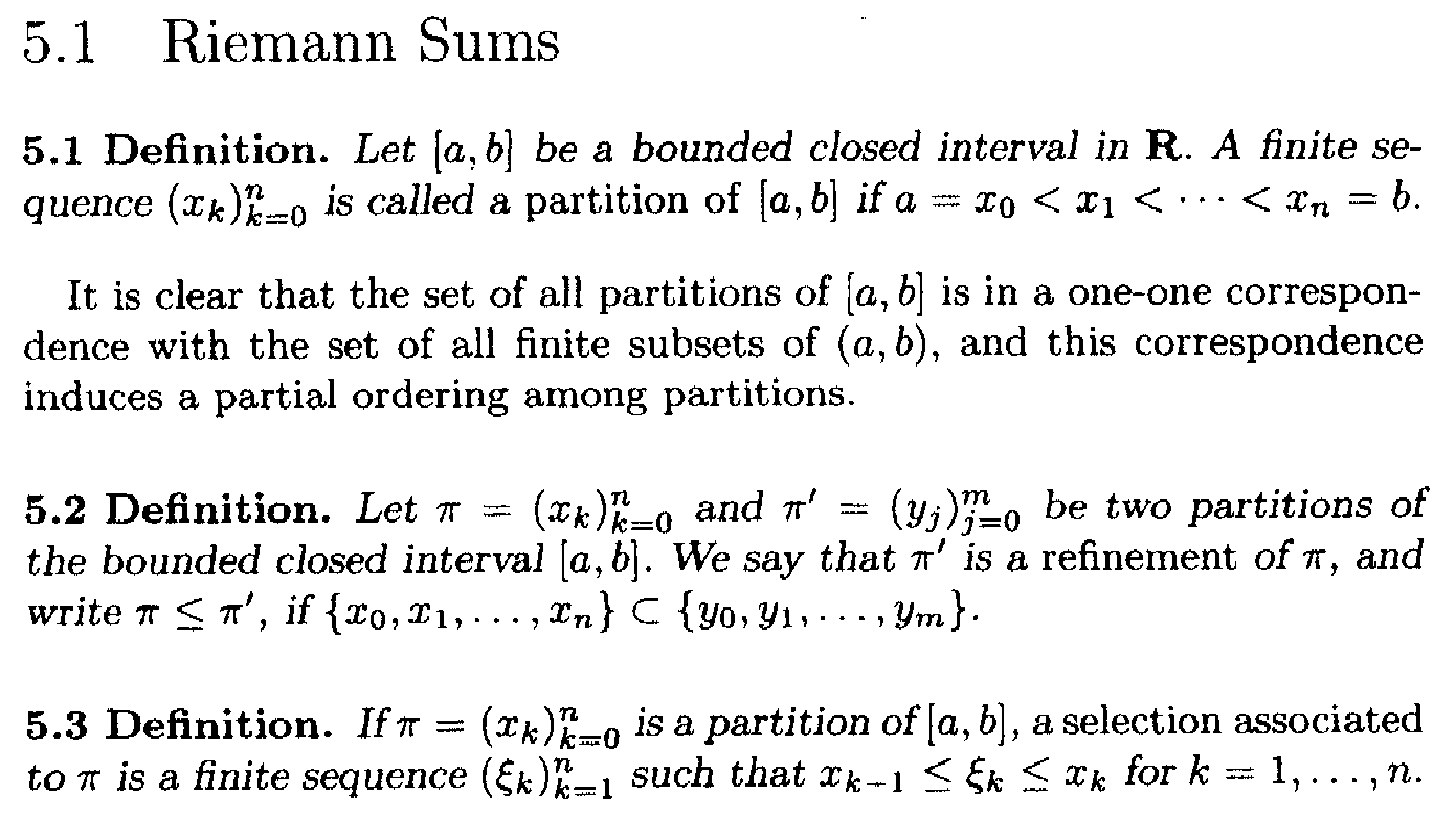

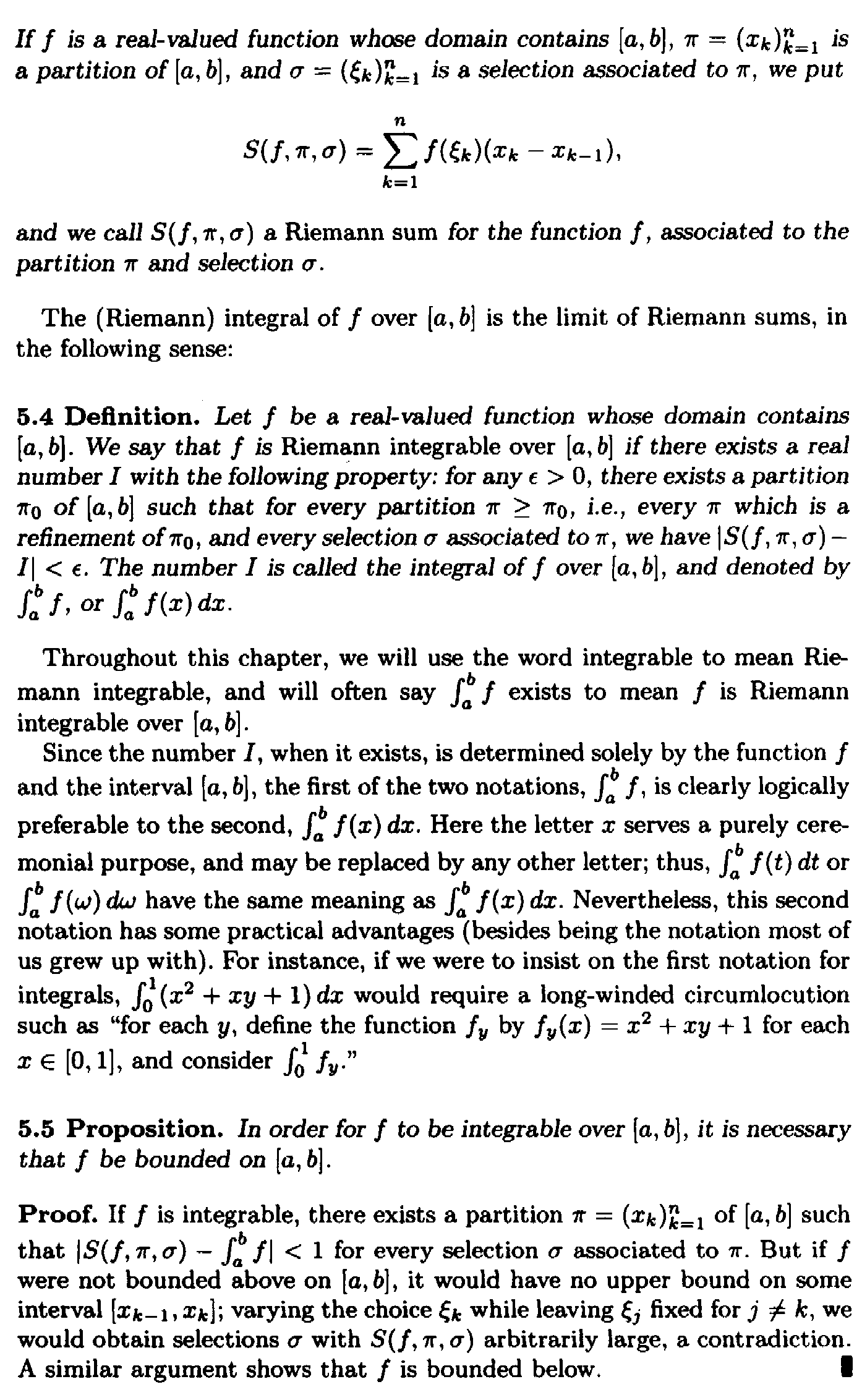

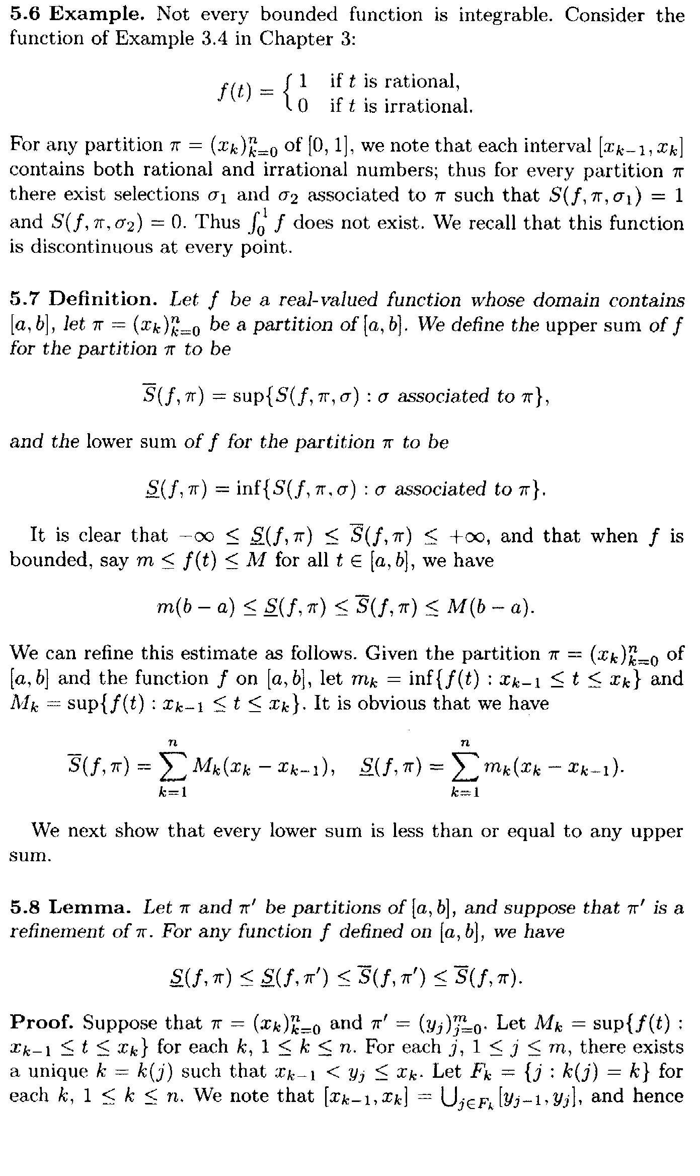

==========================================================================================Note: It may help MHB readers of the above post to have access to Browder's notation, definitions and theorems on Riemann integration preliminary to Theorem 5.10 ... hence i am providing access to the same ... as follows:
Hope that helps ...

I have been reflecting on my problem in the above post and now give my attempted proof of
$$\int_a^b f \text{ exists } \Longrightarrow$$ ... for every $$\epsilon \gt 0 \ \exists \ $$ a partition $$\pi$$ of $$[a, b]$$ such that $$\overline{S} (f, \pi) - \underline{S} (f, \pi) \lt \epsilon$$ ... ...Proof:
Let $$\int_a^b f = I $$
Then
$$I$$ exists $$\Longrightarrow$$ for any $$\frac{ \epsilon }{2} \gt 0 \ \exists \ \pi_0$$ such that for any $$\pi \geq \pi_0$$ and every selection $$\sigma$$ associated with $$\pi$$ we have $$| s(f, \pi, \sigma ) - I | \lt \frac{ \epsilon }{2}$$Now $$| S(f, \pi, \sigma ) - I | \lt \frac{ \epsilon }{2}$$
implies that
$$- \frac{ \epsilon }{2} \lt S(f, \pi, \sigma ) - I \lt \frac{ \epsilon }{2}$$
and so, obviously, we have that
$$S(f, \pi, \sigma ) - I \lt \frac{ \epsilon }{2}$$ ... ... ... ... ... (1)But $$| S(f, \pi, \sigma ) - I | \lt \frac{ \epsilon }{2}$$
... also implies that
$$- \frac{ \epsilon }{2} \lt I - S(f, \pi, \sigma ) \lt \frac{ \epsilon }{2}$$
$$I - S(f, \pi, \sigma ) \lt \frac{ \epsilon }{2}$$ ... ... ... ... ... (2)
Now we also have that
$$\underline{S} (f, \pi) \leq S(f, \pi, \sigma ) \leq \overline{S} (f, \pi) $$ ... ... ... ... ... (3)Now (1) and (3) imply $$\overline{S} (f, \pi) - I \lt \frac{ \epsilon }{2}$$ ... ... ... ... ... (4)Similarly (2) and (3) imply$$I - \underline{S} (f, \pi) \lt \frac{ \epsilon }{2}$$ ... ... ... ... ... (5)Adding (4) and (5) gives $$\overline{S} (f, \pi) - \underline{S} (f, \pi) \lt \epsilon$$ ... ...
Can someone please critique the above proof and either confirm it is correct and/or point out errors or shortcomings ...
Peter
