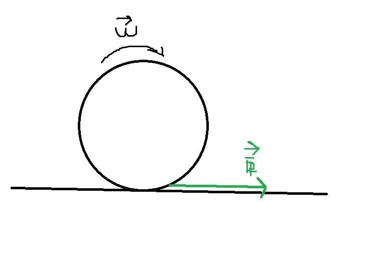

We know that when a ball is rolling ( just rolling no slipping) the frictional force is orientated in the direction of motion.
Why isn't the ball accelerating due to frictional force, if it is the only force in the motion direction?

Ff is the friction force that's making the ball roll. If Ff is the only force acting upon the ball in the horizontal direction and the ball rolles in the Ff direction, than shouldn't the ball accelerate ( not decelarate, but go on and on )
Is the ball on a level horizontal surface?
yes
RingNebula57 said:
yes
If the ball is rolling on a level horizontal surface and is continuing to roll at a steady rate then there is no sense in which we can say that friction is "making it roll". If anything, inertia is "making it roll".
The force of friction is zero and the ball has zero acceleration. This is consistent with Newton's second law. F = ma. 0 = 0.

If the force of friction was 0 than why is the ball rolling? Why isn't it just slipping ( like on ice) ?

If a ball is already rolling and it rolls onto ice (smooth, frictionless surface), then it will continue to roll.
If the ball is rolling on a rough surface it is essentially static friction. The point of the ball that touches the ground is not moving (instantaneously at rest), so the frictional force does no work. Just as it would if the ball was not moving.

The ball has inertia (eg a moment of inertia).
If it's already rolling when it encounters the ice it will keep rolling (nothing to stop it rolling)
If it's not rolling (eg it's sliding) when it encounters the ice it will keep sliding (nothing to make it start rolling)
