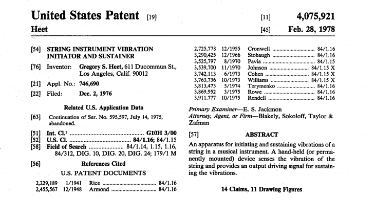

I'm no Guitar-Zan, can't even operate one..
but here's my guess-
You could excite the string without a permanent magnetized core, as you suspect
so it's not about efficacy
it's about giving the Ebow a "Go" signal.
With the permanent magnetized core ,
motion of the string will produce a small voltage in the coil telling the Ebow a string has been plucked and it can take over now..
His patent is at USPTO.gov , you can read it for free.
