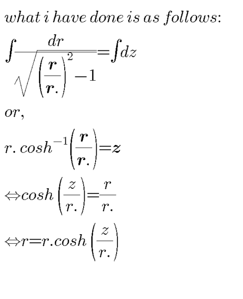

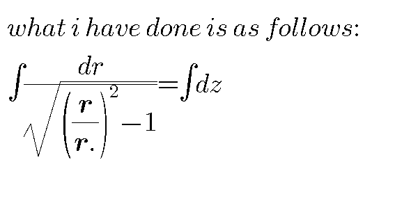

Now what to do?
Raihan amin said:
Now what to do?
Look up the integral in a table of integrals.
No. cosh x is not the solution of avove equation.
How?
See if the solution I posted in post #15 satisfies the equation.
Likes Raihan amin

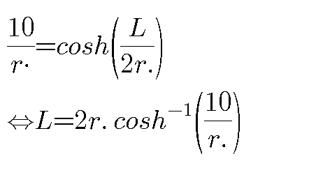

OK.then how we will find L• ?
I think this is correct.Now we have to find L•
i just saw this thread
to find l you have to apply boundary conditions
But we have only one boundary value
The boundary condition is that at z = L/2 the radius must be 10cm with the centre of the soapbfilm having some ro after certain l there is no solution for ro and hence no film
Can we find the highest L from that equation only?
Yes but the form you behave written in seems a bit complicated let 1/r be X if 1/r has to have solution then X have to have solution
Please carry out
What
  • #31
I don't understand that.would you please do it for me?
  • #32
no i can't help you do it but
\frac {10}{r_0} = cosh(L/2 r_0)\\
\frac{1}{ r_0} = x\\
10 x = cosh (Lx /2)
