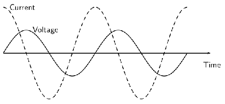

In an AC circuit with only a capacitor this diagram represents the relation between the current and the voltage in it (the current leads the voltage by 90 degrees).
and because: (I= dQ/dt) and ( Q=C*V)
where: Q is the amount of charge, C is the capacitance and V is the potential difference between the plates of the capacitor.
Then: I=C (dV/dt).
In the diagram above my textbook refers to the slope of the tangent of the voltage curve to be (dV/dt), and I don't understand it, could you please explain this for me? Regarding that I don't actually know how to determine the slope of a tangent of a curve.
Slope of the tangent at a point on the function is the derivative of the function at that point. It is a very big topic in calculus, called differential calculus.
Could you be more specific about what you don't understand in that graph?
Try: My textbook refers to the slope of the voltage versus time curve to be (dV/dt). To find this slope you draw a straight line that is tangential to the voltage curve, and the slope of this straight line is the slope of the curve at that point.

If y=f(x), dy/dx is the slope of the tangent to the curve. Here, voltage V is a function of time t. So, dV/dt represents the slope of the curve (which is same as slope of the tangent to the curve at a point).
As you can see, slope of the voltage curve at its peak point is zero (the tangent is parallel to the time axis). This means, the capacitor current is zero, which is shown in the current waveform.

Think of it as ∆V/∆t
where ∆V is the small change in V that occurs during a small change in time, ∆t
and you can measure ∆V and ∆t off the graph, choosing ∆t to be any measurable small change in time, i.e., of your own choosing

Referring to #7, where Δt is a small (infinitesimal) change in time, the derivative is given by,
dV/dt=lim Δt→0 (ΔV/Δt).

A constant current source delivers a constant current to the load. So given your equation...
I=C(dV/dt)
...if I is constant then dV/dt is constant. The result is that the voltage on the capacitor increases at a constant rate/constant slope. In the real world this can't happen indefinitely as the voltage would get too high, however such a circuit could form the basis of a triangle wave generator.
