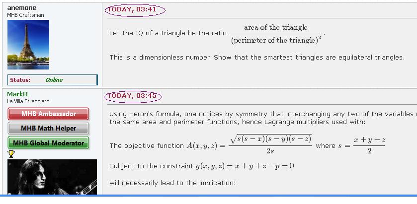

Let the IQ of a triangle be the ratio \(\displaystyle \frac{\text{area of the triangle}}{(\text{perimeter of the triangle})^2}\).
This is a dimensionless number. Show that the smartest triangles are equilateral triangles.
Mathematics news on Phys.org
Using Heron's formula, one notices by symmetry that interchanging any two of the variables representing the side lengths results in the same area and perimeter functions, hence Lagrange multipliers used with:
The objective function \(\displaystyle A(x,y,z)=\frac{\sqrt{s(s-x)(s-y)(s-z)}}{4s^2}\) where \(\displaystyle s=\frac{x+y+z}{2}\)
Subject to the constraint \(\displaystyle g(x,y,z)=x+y+z-p=0\)
will necessarily lead to the implication:
\(\displaystyle x=y=z=\frac{p}{3}\)
Thus, the triangle having the greatest IQ is equilateral.
