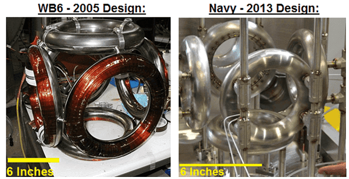

This experiment specifically went for (-) plasma; AKA the "quasineutral" assumption does not apply. The Navy/LANL team injected 3 amps of electrons for 150 microseconds at 7,200 volts. This is what the device looked like compared to earlier (2005) experiments:

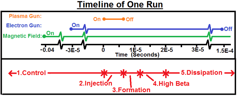

This was inside a cube vacuum chamber, 45 cm a side. The electron guns were the blue objects. The plasma guns are in red. For a shot, the Navy had control of three variables: (1) plasma gun (2) electron gun and (3) the containing magnetic field. Here is a timeline of one shot:
This experiment had five stages to it:
1. Control - The chamber is under vacuum (no pressure is given) and magnetic fields are on.
2. Injection - This is when the electron and plasma guns are switched on.
3. Formation
4. High Beta Mode - This is the fabled "cusped plasma confinement"; long predicted, never observed.
5. Dissipation

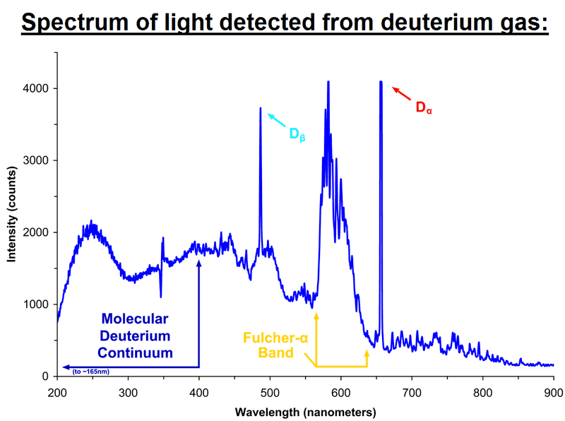

Much of their data comes from shielded detectors, reading a light signal. In visible, X-ray, ect.. I need a better understanding of expected output from a plasma cloud like this. For example, if the cloud was just deuterium the light coming off of it would look like this:
In this case, the navy blocked all but the H-Alpha line. That is the spike at 656 nanometers.
Unfortunately, I can only guess at what the plasma was made of (see my list above). The odd component was carbon. Normally, the system would be deuterium, deuterium+, electrons and a trace of junk. They injected carbon. Finally, I know there are formulas to predict these spectra and that maybe a good place to start.

A pure electron plasma doesn't have a spectrum. You need some other ion species in there. There are two major types of light emission from a plasma: line emission and bremsstrahlung. Line emission comes from electrons bound to nuclei, so there is none from free electrons. Bremsstrahlung comes from the interaction between two different species in a plasma, such as electrons and hydrogen ions. You don't get bremsstrahlung from a pure electron plasma.
