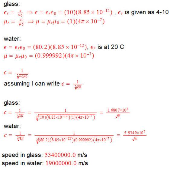

Hi,
The speed of light is given c=1/√(ε0μ0) where ε0 is permittivity of vacuum and μ0 is vacuum permeability.
The permittivity and permeability of a material is given as ε=εrε0 and μ=μr0 respectively where ε is absolute permittivity of the material and εr is relative permittivity of the material with respect to vacuum. The same goes for permeability.
The speed of light in water is given as 2.25×108 m/s and in glass it is around 1.95×108 m/s.
I assume that speed of light in a certain material could be stated as c=1/√(εμ).
It looks like one cannot write c=1/√(εμ) because as you can see and as was expected that calculated value of speed of light in glass is lager than that of water.
So, how do we really calculate the speed of light in a material using its permittivity and permeability values, or where am I going wrong with my calculation?
Thank you!

I don't think you can assume Er for water is around 80 at optical frequencies. Er for water varies in a complex way with frequency.

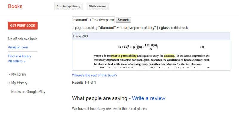

Your help is really appreciated.I used the following webpage for μr of diamond, http://hyperphysics.phy-astr.gsu.edu/hbase/Tables/magprop.html .
It says, "Here the quantity Km is called the relative permeability, a quantity which measures the ratio of the internal magnetization to the applied magnetic field. If the material does not respond to the magnetic field by magnetizing, then the field in the material will be just the applied field and the relative permeability Km =1. A positive relative permeability greater than 1 implies that the material magnetizes in response to the applied magnetic field. The quantity χm is called magnetic susceptibility, and it is just the permeability minus 1."
For Carbon (diamond) χm is -2.1 which means relative permeability, Km, is -2.1+1=-1.1
But as now I see it it's a different relative permeability because it's not given in reference to vacuum's permeability.
I will look for the other relative permeability value for diamond which, as you say, is never negative and let you know. Thanks a lot.
Thank you!
Lord Jestocost said:
ead the table header in http://hyperphysics.phy-astr.gsu.edu/hbase/Tables/magprop.html
For Carbon (diamond) χm is -2.1x10-5.
Yes, you are correct. I did see that "10-5" but forgot to mention it.
According to this source, the μr of diamond is "1".
Link to the source: https://books.google.com/books?id=v...ved=0ahUKEwj3uPTVvevfAhWxuXEKHb8SAeoQ6AEIKDAA

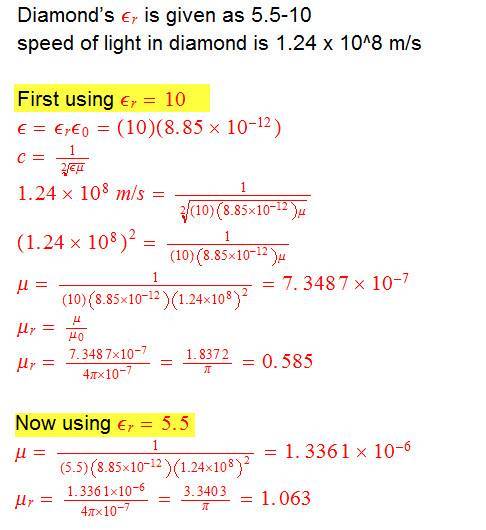

I also tried to calculate it myself.
Again, the speed of light in diamond is 1.24x108 m/s and in water it is 2.25x108 m/s although in view of the formula c=1/√(εμ) speed of light in diamond should be greater than in water because for diamond the product "εμ" is less than that of water. But again I think it has to do with variable values of both ε and μ with respect to EM frequency.
Please let me know if I have it correct. Thanks a lot.
