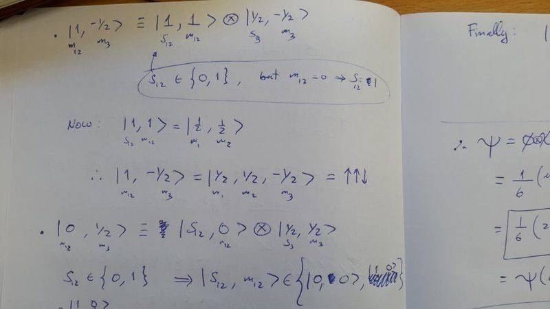

Hi, guys.
If I want to write the spin-flavor wavefunction of ##\Sigma_+## starting only from knowing that the quark content of the proton is ##uud##, how can I procced?
I started by applying the ladder operators in order to get the baryon octet vertexes. I am now having problems with:
  1. determining the flavor wavefunction for the center octet states (including ##\Sigma_+##).
  2. determining the spin wavefunction for ##\Sigma_+##. Even if I suppose that the its spin state is ##|1/2,1/2\rangle##, there is more than one way for this to happen when we combine 3 spin 1/2 quarks...
Does anyone know a text where I can find something like this done in a comprehensive and detailed way? Or, alternatively, can you tell me a way to do it?

The problem is that I did not understand the derivation of the proton wavefunction also: I found Griffiths, and for that matter every other text I found on the subject, quite confusing. Do you happen to know a place where it is clearly and thoroughly explained?
Using Thomson's book I understood the derivation of the proton spin-flavour wavefunction. I will try to apply what I learned to this case.

To make myself clear, I posted my attempt. I arrived at the correct wavefunction, but I have a problem with it: even though it seems symmetric, I would expect it to be only mixed symmetric (only symmetric in 1,2), since ##X## is only symmetric in 1,2 and ##\phi## is completely symmetric...

Why is phi symmetric? aren't you using a uds? I am sorry but I don't see why you wouldn't consider the antisymmetric singlet.
When determining ##X##?
when determining Phi...
you should have a symmetric one (in the triplet I=1 combination) : [itex] uds + dus[/itex]
and an antisymmetric one (in the singlet I=0 combination) : [itex] uds - dus [/itex]
they both correspond to I3=0
