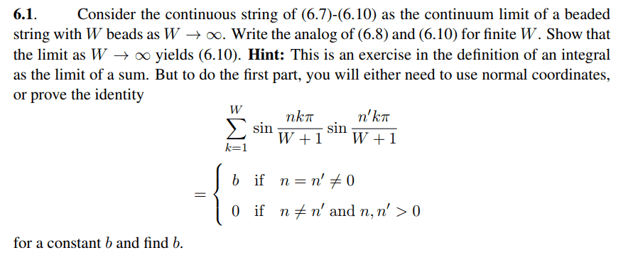

I have encountered this problem from the book The Physics of Waves and in the end of chapter six, it asks me to prove the following identity as part of the operation to prove that as the limit of ##W## tends to infinity, the series becomes an integral. The series involved is as follows:
##\sum_{n=1}^{W} sin(\frac {nk\pi} {W+1}) sin(\frac {n'k\pi} {W+1})##
I need to prove that:
##\sum_{n=1}^{W} sin(\frac {nk\pi} {W+1}) sin(\frac {n'k\pi} {W+1})=b## when ##n=n'## and ##=0## when ##n \neq n'## where ##n, n'## are positive integers.

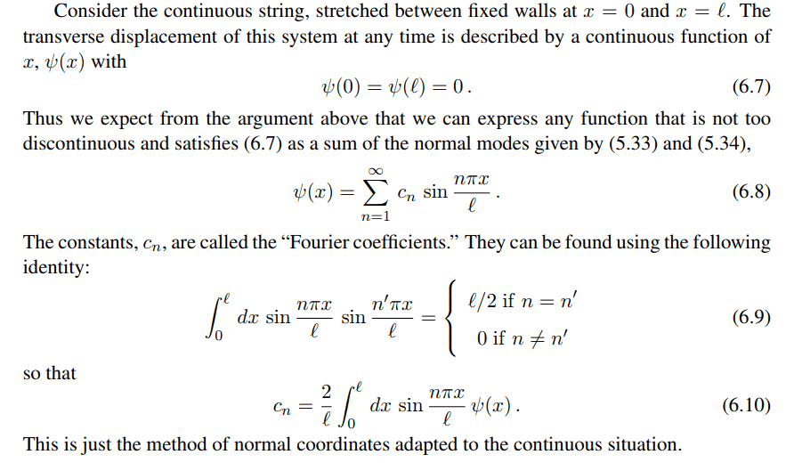

There are subtle differences between your problem statement and what I found here , also at the end of chapter 6 :rolleyes: :
and, for completeness:
and yes, trigonometric identities is the way to go.

Ahh yes thank you for your addition. However, what should my next step be?
It's not really an addition... :rolleyes:
For ##\ n=n'\ ## you are done quickly.
