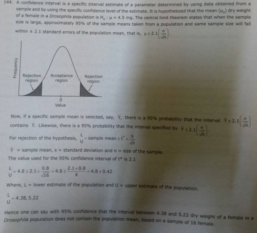

It is hypothesized that the mean dry weight of a female in a Drosophila population is 4.5 mg. In a sample of 16 female with ȳ =4.8 mg and s = 0.8 mg, what dry weight values would lead to rejection of the null hypothesis at p = 0.05 level?
(take t0.05=2.1)
1. Values lower than 4.0 and values higher than 5.6
2. Values lower than 3.20 and values higher than 6.40
3. Values lower than 4.38 and values higher than 5.22
4. Values lower than 3.22 and values higher than 6.48
Ans is 3.
I know basic t-test but I have no clue to solve this question.
Thanks.

The book I'm following has provided a solution to this question which is too complex for me. It talks about central limit theorem.

What in particular don't you understand? You say you "know basic t-test". Do you mean you know a formula that you apply blindly, or do you understand where it comes from?
The question as you state it (have you copied it correctly?) is badly expressed and unclear. The answer also contains mistakes, e.g. in the last line "does not contain" should be "contains". The paragraph immediately after the diagram should read
"... there is a 95% probability that the interval μ ± 2.1(σ/√n) contains Y. Likewise, there is a 95% probability that the interval specified by Y ± 2.1(σ/√n) contains μ."
If the value of the hypothesised mean was greater than 5.22 or less than 4.38, you would reject the hypothesis on the basis of the data. This is what answer 3 must mean. But they tell you that the hypothesised mean is 4.5. It makes no sense.

I'm afraid your post illustrates that "only knowing how to apply formulae" without understanding them means that you will sometimes apply them wrongly.
Your H0 is nonsensical - of course there is a difference between 4.8 and 4.5. Do you mean "the difference is not statistically significant at the 0.05 level"? Similarly with Ha: "There is a statistically significant difference..."
What do you mean by SE = s/√n - 1. As written it is ambiguous. Do you mean s/√(n - 1), or s/(√n - 1), or (s/√n) - 1? I suspect the first, but that is wrong - it should be s/√n.
0.3/.21 is not 0.38, it is 1.43 - which is still not greater than 2.1, so why do you reject the hypothesis? And "t0.05,15 = 1.7" is wrong - that is a single-tailed value, while you are looking for the two-tailed value.
