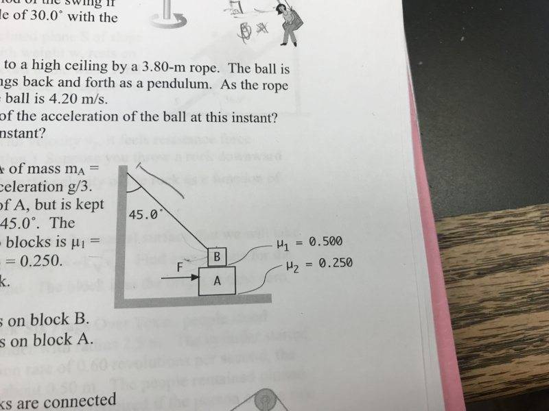

A force F is applied horizontally to a block A of mass mA =
0.600 kg so that it slides on the floor with acceleration g/3.
Block B of mass mB = 0.200 kg rests on top of A, but is kept
in place by a cord which is tied to the wall at 45.0°. The
coefficient of kinetic friction between the two blocks is μ1 =
0.500 and between block A and the floor is μ2 = 0.250.
(a) Draw a free-body diagram for each block.
(b) Find the tension in the cord.
(c) Find the normal force that block A exerts on block B.
(d) Find the normal force that the floor exerts on block A.
(e) Find the force F.

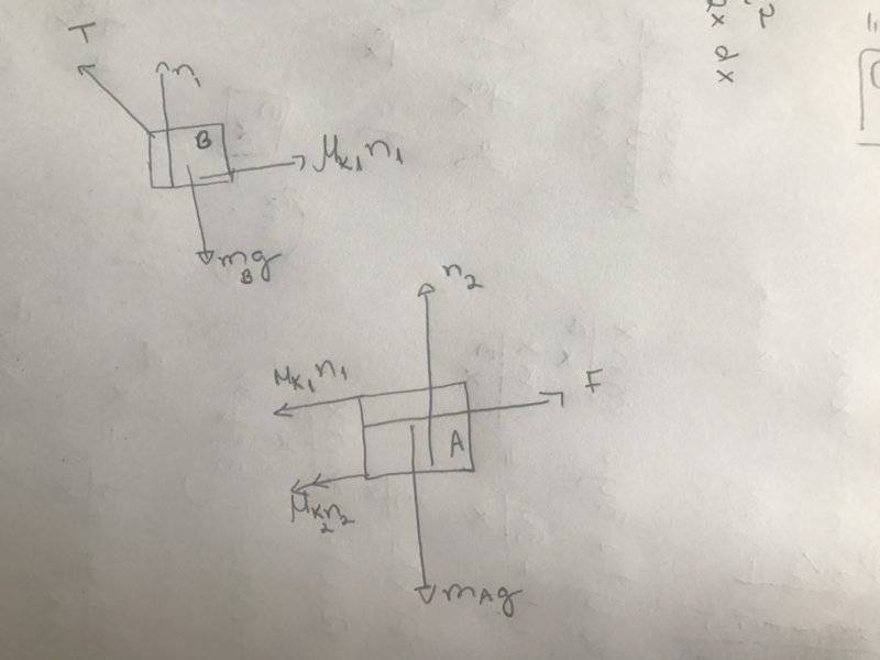

Yes, I did the free body diagram. It is attached here.
Honestly, I haven't used any equations on it yet. My initial thought was to think about Force net and tension and they are the sum of the forces acting in the system, right? Obviously, it also uses the second law of Newton F=ma, but I don't really see how to get on this step yet.

From your diagram for block B, you should be able to find (b) and (c) without reference to block A at all.
For block A, you don't seem to have shown any vertical force from B. Think about Newtons 3rd law for the force n1 .
I presume n2 is the force from the floor pushing A upwards. The 3rd law force acts on the floor (Earth).
You show the force from the gravity of Earth pulling A downwards. The 3rd law force acts on the Earth.
Edit: PS. Do you remember sin(45)=cos(45)
Edit2: PPS. You seem to use force symbols which do not appear on your diagrams (S, W, Fy ). IMO this is unhelpful. I think you can mark on all the forces you need and use only those in your equations.
