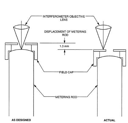

The error was not the mirror shape- the mirror was perfectly ground. The error came from the null corrector used to set the shape. Perkin Elmer, the relevant contractor, was also the contractor that figured the primary mirror for the KH-11 series of spy satellites, upon which the Hubble design is (was?) based. Analysis (http://ntrs.nasa.gov/search.jsp?R=19910003124) shows that the field lens of the null corrector was set 1.3mm too far from the nominal position due to misalignment of the metering rod. That 1.3mm distance error is sufficient to explain the aberrations.
(from the linked report, bf mine):
"With one end of the metering rod presumably located at the center of curvature of the lower RNC mirror, the field lens was then brought up to the end of rod B, but there was no adjustment left in the screws used for this positioning. More adjustment room was made by inserting spacers between the field lens and the lower mirror mounting plate. The adjustment mechanism was found not to be staked. Staking, i.e., securing the mechanism to prevent inadvertent movement, was a specified procedure. The final location of the field lens was then set with the addition of the spacers. As a result, the field lens was about 1.3 rnm too far from its correct position relative to the lower mirror."
All of the alignment jigs were constructed based on a 200 mile object distance, the Hubble null corrector was kludged to set the object distance to be infinity, but not all the jigs were reconfigured properly.

But that's just it- the grinding process yielded the correct surface. Do you understand the process by which lenses and mirrors are figured? Surfaces are ground to a *reference* shape. Let's say you are grinding me a mirror, because you (rightly) take pride in being the world's best grinder, and I give you the reference shape. Oops- I gave you the wrong reference. Who is at fault?
Now go a step further: I give the reference shape to a third party who installs the reference in your grinding jig. This time, the reference is good but the installation was flawed. Now a wrinkle- I told the installer to adjust the installation procedure, but did not document (or validate) the modified procedure very well. Now what?
Hubble was a process error, not a grinding error.
It might be a matter of semantics, but I don't think so. The "correct surface" is the expected shape for the telescope - the surface that would produce sharp images in space. The grinding process yielded a surface that passed the flawed test, which means the surface had the wrong shape.
It is not the fault of the grinding process - they got it wrong because the test setup was wrong. That doesn't make the resulting shape "right". Being responsible and being correct are different things.
