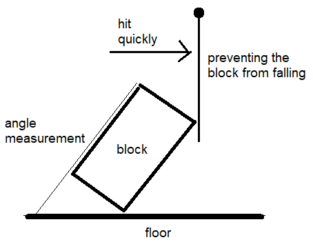

I did a primitive experiment. I used some cut cardboard to give my red brick an initial tilt of 35 degrees from the vertical. Then I let it rotate from rest to the ground (tilt = 90 degrees), recording the sound of this on a mobile phone. It all happens so fast.
The experimental toppling time is about 0.4 or 0.5 seconds.

Apologies for not including more info. Here is more detail including my code for various calculations like the acceleration factor.
I realized that I used the wrong width. I rotated the brick on the edge with length 0.104 m, so this is not the width, it is the depth. The width is the 0.075 m side.
My program now gives a smaller toppling time = 2.1 seconds
Still four times greater than the rough experimental result of 0.5 sec

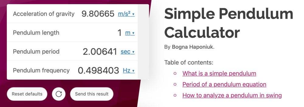

##(1/2)*0.95=0.47## ##seconds##
Your measured result is fairly close to 1/2 the pendulum period for that length...

The pendulum calculator doesn't help here.
The distinction between a pendulum and an inverted pendulum involves a factor of ##\sqrt{-1}## in addition to the constant factor that is being glossed over.

Metastable raised the simple pendulum calculator.
I see that the acceleration of a simple pendulum, like the toppling brick, involves a sine
a = minus amplitude * w^2 * sin(wt)
However, I am not clear about how the pendulum helps as the brick has width and so does not have a tipping point at vertical. You put the pendulum length equal to the brick height of 0.225 m and got a pendulum period of 0.95 seconds. Is this just a rough check on the expected toppling time from 35-degree tilt?

Good. Now with the prediction side fixed let's look at the experimental side. How do you determine the starting time of the fall? How accurate is the starting angle?
Here is how I would set up the experiment, the quick retraction of the element stopping the block gives a good starting time measurement:
