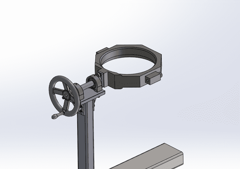

Hello everyone,
I am trying to design a fixture that can clamp onto and turn an equipment 180 degrees for maintenance.
I am trying to figure out what torque will be required at the hand wheel to turn it.
The piece of equipment will be clamped at its center of gravity. However, its mass is not symmetrical.
Pleases guide me along this problem. Thank you

Here are the mass properties of the equipment that needed to be turned.
source: Solidworks Mass = 673.280 pounds
Volume = 3065.995 cubic inches
Surface area = 9939.267 square inches
Center of mass: ( inches )
X = 0.012
Y = 7.023
Z = 0.002
Principal axes of inertia and principal moments of inertia: ( pounds * square inches )
Taken at the center of mass.
Ix = ( 0.000, 1.000, 0.001) Px = 23871.534
Iy = (-0.997, 0.000, 0.072) Py = 37167.538
Iz = ( 0.072, -0.001, 0.997) Pz = 37745.029
Moments of inertia: ( pounds * square inches )
Taken at the center of mass and aligned with the output coordinate system.
Lxx = 37170.503 Lxy = 1.103 Lxz = -41.273
Lyx = 1.103 Lyy = 23871.541 Lyz = 9.484
Lzx = -41.273 Lzy = 9.484 Lzz = 37742.057
Taken at the output coordinate system.
Ixx = 70379.321 Ixy = 55.828 Ixz = -41.258
Iyx = 55.828 Iyy = 23871.633 Iyz = 18.187
Izx = -41.258 Izy = 18.187 Izz = 70950.963

1) How will you get it mounted so that the CG will be on the axis of rotation? What is your location tolerance?
2) Given the worst case location tolerance (CG farthest from axis of rotation), what is the worst case torque (CG is horizontally displaced from axis of rotation)?
3) How much force can a normal person exert on a handwheel handle? From that, calculate the minimum handwheel diameter.
4) Is there a reason why the operator cannot turn it by grabbing the object directly? No handwheel.
5) How fast does the operator need to turn it 180 degrees? If more than about 10 seconds, then acceleration/deceleration torque can be ignored. I faster than 4 or 5 seconds, then you need to calculate acceleration/deceleration torque about the axis of rotation.
The above is enough for you to get started. Work through the above carefully, then we can help you with the next steps.
Excellent question!
$$ \sum T = I \frac{d^2 \theta}{dt^2}$$
What is the moment of inertia of the body about the axis you wish to rotate it about? Your coordinates of the mass center and MOI calculated by the program are RELATIVE to the CM coordinate system in your 3D model. Which axis are you rotating about. Is that axis coincident with a principal axis? I simple diagram of the part ( indicating the axis of rotation ) would greatly help.Then you are going to have some opposing torque that is a function of the bearing load ( and the quality, type of bearing), and a torque applied by the operator ( through the wheel )
