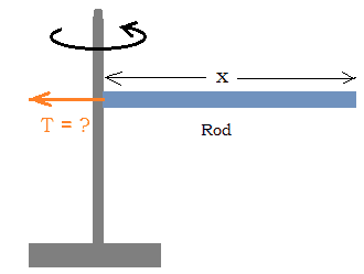

Find the total tension acting on a rod rotating about its end with an angular velocity of w as a function of its length x(length)
F = ma[/B]
Let the function be T(x) where x is the length of the rod.

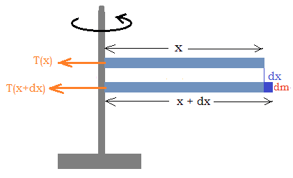

Considering an interval between x and x + dx
For an increment in dx, let the function change by dT(x)
dT(x) = T(x+dx) - T(x)
T(x+dx) is the tension acting on a rod of length x + dx
T(x) is the tension acting on a rod of length x
Therefore, dT(x) is the tension acting on the tiny element of length dx
dT(x) = dm(w^2) x
dm = ρdx
∫dT(x) = ρ(w^2)∫ xdx from T(x) = 0 at x = 0 to T(x) at x = x.
This gives me tension as a function of the length of the rod
Is what I've done correct & rigorous? Is my general approach to calculus alright or am I viewing things wrong?
T(x+dx) is the total tension acting on a rod of length x + dx
T(x) is the total tension acting on a rod of length x
I've simply summed these up from 0 to x

At what cross section is the tension T(x+dx) acting?
Could it be that the question is asking for the tension T in the rod at the left end of the rod as shown below?
If T(x) is the tension at the left end of the rod when the rod has a total length x, then I think your analysis in your first post is OK. So, when you switch from x to x + dx, you are actually talking about two different rods (as you clearly said):
The difference in T(x+dx) and T(x) must provide the centripetal force for the extra mass dm of the longer rod. Your work looks correct if this was your way of looking at it. So, T(x) does in fact increase as x increases. And T(x) = 0 when x = 0.
Sorry for not seeing this sooner.
You don't need to approach it this way. In fact, you don't need calculus at all if you know the principle that the center of mass of an object has an acceleration acm given by
Fnet, external = Macm.

Okay, thanks!
