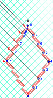

Here's a diagram based on my Relativity on Rotated Graph Paper Insight.
(You can use https://www.geogebra.org/m/HYD7hB9v to draw parts of the diagram below.)
In the frame of the stay-at-home twin (on which the gridlines of the rotated graph paper are based),
we draw the ticks for each "traveling" twin (each with speed (3/5)c).
Then, I show the light signals sent by the "positive-x" twin... Think of it as the "negative-x" twin watching an 8 hour tv show broadcast by the "positive-x" twin.
Due to their relative motions, the viewer sees that show with irregular timing.
(You can imagine that each has the same 8-hr movie started at separation...and that one twin is comparing the received broadcast with her own local playback of the movie.)
The ticks of the stay-at-home twin are not shaded in... but you can shade them into realize that
at reunion, 10 ticks elapse for the stay-at-home twin while 8 ticks elapsed for each of these symmetrically-traveling traveling-twins.
You could also analyze what each (traveling or stay-at-home) twin sees from the other two twins.
You could also try asymetrical twins, as well as trips with asymmetrical there and back legs.
(One could try to interpret the situation using light-travel time corrections and change of lines of simultaneity, etc... but I feel that this presentation is direct and to the point.)

You can see what happens exactly in the video here, where the lorentz transformation formulas have been used to map events that happen at x,t measured by the stay at home twin (left diagram) to x', t' in the right diagram, which represents the traveling twin's perspective.
On the left diagram, the cyan coloured clock represents the stay at home twin's clock measured from the stay at home twin's perspective, while the white clock is is the what we _interpret_ at the traveling twin's clock.
In the right diagram, the white clock represents the traveling twin's clock from the traveling twin's perspective, while the blue clock is what we _interpret_ as the stay at home twin's clock.
What are the numbers and what are the moving circles/dishes in the diagrams? Generally speaking, those are all events which in the left diagram happen at x,t and are then mapped to the right diagram where they are measured at x',t', using the Lorentz transformation formulas.
More detailed, the numbers represent clock counts. In the left diagram, all but the traveling twin's clock are at rest seen from the stay at home twin's perspective, which is why you see the instances of the clocks, displaying different clock counts, all being on an (imagined) straight, vertical worldine.
A clock that is measured to be at rest from the perspective of the stay at home twin, would be measured to be moving from the perspective of the traveling twin, and therefore the instances of a certain clock which is at rest relative to the stay at home twin and are on a (imagined) vertical line on the left diagram, will be on a angled line in the right diagram(between 0 and 45° for this type of diagrams).
The reason why i am pointing out that those instances of the clocks on the simultaneity axis are merely what we interpret as moving clocks which are simultaneous to us, is because this is just a physical definition we agreed upon.
If you look at the video, particularly at stage 3 and 4, you see how the blue clock in the right diagram (the filled blue circle), ticks much faster in phase 3 and 4 when the traveling twin accelerates. "Its count goes up much faster" relative to the traveling twin's clock local to him.
This means, the traveling twin will measure a future instance of the blue clock to be on the simultaneity axis post acceleration. However, he could decide to accelerate in the opposite direction again, and then the instance of the blue clock which lies on the simultaneity axis as measured by the traveling twin would be one of the past compared to the one before accelerating into the opposite direction.
The traveling twin could keep doing this "acceleration dance" and the instance of the blue clock which is measured by the traveling twin to be on the simultaneity axis, would seemingly be "moving forwards and backwards in time" on repeat.
So one has to be careful in what the simultaneity axis really is. It is an axis which has been defined in physics accurately, but it NOT the axis where events happen "at the same time" to us when by "at the same time" we are asking "what is my friend doing/feeling right now". They happen at the same time only in the sense of having the same t or t' coordinate.
Unfortunately, consciousness or subjective experience is beyond the scope of physics but it is nevertheless important to understand that when we talk about events happening at the "same time" in relation to the twin paradox, as physicists, we merely mean they have the same t or t' coordinates and therefore lie on a specific axis we defined as the simultaneity axis precisely.
Physical time has been defined precisely, but it completely ignores the "present" or "now (subjective)experience". Hence, physicists do not care how consciousness travels through the block universe on a worldline and or when two worldlines cross, the two consciousnesses traveling those worldlines would actually meet at the cross-points or not at all.
Yet, unless we are ok with meeting zombies at the worldline crossing points, we would have to come up with a "meta-physics" which takes this into account as well. (I will be starred at for typing this, i know... but someone had to say it)
It would be absurd to assume that events happening at the same physical time as in having the same t or t', actually happen at the same time as in what two people experience at the same time, shown by the example with the "acceleration dance" above.
Note that what you describe here is not a valid coordinate system. A coordinate chart on spacetime is a one to one mapping between events and coordinates.
