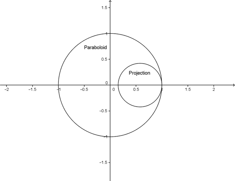

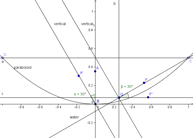

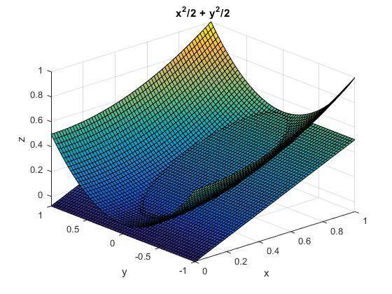

I thought I'd include some pictures:

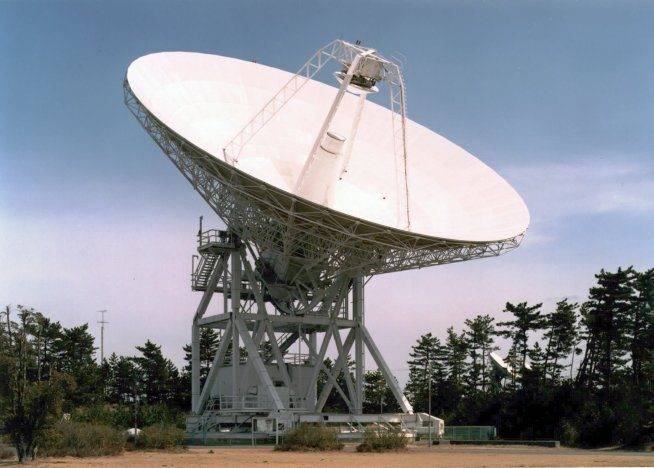

Since the OP talks about the diameter and depth of the antenna, I thought the shape should be more like this:
But obviously shallower. It would be like having a large bowl tipped to one side and partially filled with water, like this:
I didn't get that from your pictures.

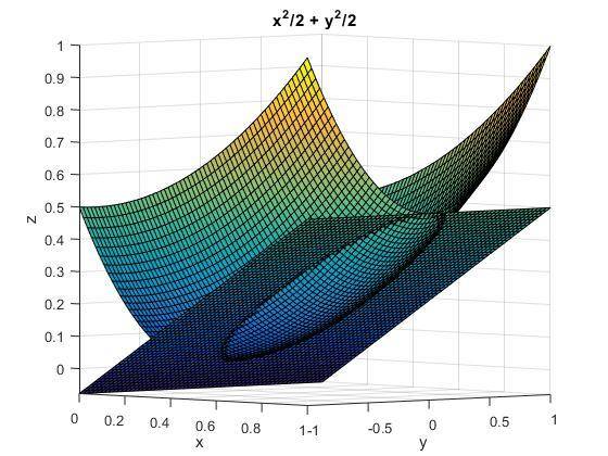

Yeah, I sort of zoomed in on the intersection in the picture generated by Matlab, since it is tiny compared to the entire paraboloid. You wouldn't happen to know what I'm doing wrong, would you? :wink:
It looked to me like your antenna was more in the shape of a parabolic cylinder than a paraboloid.
http://mathworld.wolfram.com/ParabolicCylinder.html
Even at the scale at which your pictures are drawn, the top of the antenna should definitely show a circular shape, since the diameter is 2.0 m, rather than the elongated shape which is actually depicted.
The fact that you integral is evaluating to a complex result also suggests something else is wrong in your derivation.
You can't just squint at the final result and pretend to see only the real part while ignoring the imaginary part. :rolleyes:

My guess is the picture looks weird since I drew the surfaces using the ezsurf() -function. It plots surfaces into rectangular boxes, cutting their edges off. Getting back on point, I might have made a small mistake evaluating the value of the coefficient ##a##. The point (1,1) is not on the projection of the paraboloid. If I instead made things easy for myself and looked at point (1,0), ##a(x^2 + y^2) = a = 1## and if ##z_1=z_2##, then

My guess is the picture looks weird since I drew the surfaces using the ezsurf() -function. It plots surfaces into rectangular boxes, cutting their edges off. Getting back on point, I might have made a small mistake evaluating the value of the coefficient ##a##. The point (1,1) is not on the projection of the paraboloid. If I instead made things easy for myself and looked at point (1,0), ##a(x^2 + y^2) = a = 1## and if ##z_1=z_2##, then$$

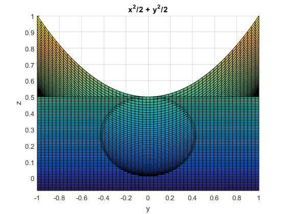

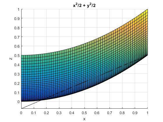

\frac{1}{\sqrt{3}}x + \frac{1}{2} - \frac{1}{\sqrt{3}} = x^2 + y^2$$
The left side is ##z## on the plane, but isn't ##z## on the paraboloid ##z = \frac 1 2 (x^2+y^2)##?
Looks like my original derivation of ##a## was right, after all. Otherwise the paraboloid's height wouldn't be 0.5 at ##x = 1##. Here's a better picture from the side:
I'm pretty sure the function for my water surface is correct, looking at this picture, and the equation for the paraboloid also seems to be correct. The angle ##\alpha## between the vertical and the axis of symmetry and ##\beta## should be equal, so my calculation of the slope should be correct as well. What the heck am I doing wrong?
Another picture from the direction of the axis of symmetry:
It seems clear to me that the limits of integration should then be:
\begin{cases}
y: \pm \sqrt{\frac{4}{3} - \frac{2}{\sqrt{3}}}\\
x\text{ as a function of y}: \pm \sqrt{\frac{4}{3} - \frac{2}{\sqrt{3}}-y^2} + \frac{1}{\sqrt{3}}\\
z\text{ as a function of x and y}: \frac{1}{2}(x^2 + y^2) \text{ and } \frac{1}{\sqrt{3}} + \frac{1}{2} - \frac{1}{\sqrt{3}}
\end{cases}
My integral would then be
\begin{equation}
V = \int_{-\sqrt{\frac{4}{3} - \frac{2}{\sqrt{3}}}}^{\sqrt{\frac{4}{3} - \frac{2}{\sqrt{3}}}}\int_{-\sqrt{\frac{4}{3} - \frac{2}{\sqrt{3}}-y^2} + \frac{1}{\sqrt{3}}}^{\sqrt{\frac{4}{3} - \frac{2}{\sqrt{3}}-y^2} + \frac{1}{\sqrt{3}}}\int_{\frac{1}{2}(x^2 + y^2)}^{\frac{1}{\sqrt{3}}x + \frac{1}{2} - \frac{1}{\sqrt{3}}} 1 dzdxdy
\end{equation}
Using the following (fixed) code this time with all correct signs inside the radicals I get:

Then the real part of ##V\approx 0.025##, and since we used the units ##m^3## in our calculation, this is equal to ##25 \times 10^{-3}m^3 = 25dm^3 = 25 liters##, which is the correct answer.
Why is it including the imaginary part, though?

1.226 × 10-34 i ≈ 0
Maybe you don't need > 20 decimal places of precision on your calculations. 13 orders of magnitude is good enough to gauge the diameter of the orbit of Pluto to within about 1 meter.
