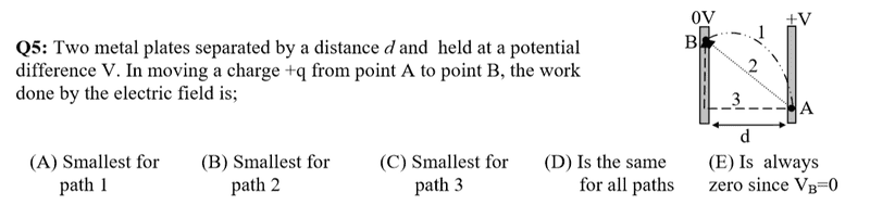

The work done by the electric field between two plates
In summary, the conversation discusses the relationship between electric field, potential difference, and potential energy between charged plate conductors. The conclusion is that since the electric field is constant, the potential difference and potential energy do not change. The answer is (D), which was initially stated as (C) due to a typo.
Fatima Hasan
319
##V=Ed##
##ΔU=ΔV Q##
Since the electric field is constant between charged plate conductors , d and the potential difference (ΔV) don't change.So, the potential energy (ΔU) remain the same .
The answer is (C). Right ?
Sounds good to me. The change in potential and potential energy is the same for all paths.
How did you deduce this from the above?
(C) is a typo , my answer is (D) .
That's better. :smile:
Likes Fatima Hasan
