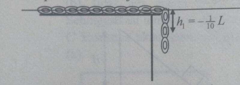

A chain with length L and mass m is placed on a table with frictionless surface.If one-fifth of the chain is hanging at the end of the table, how much work that is necessary to pull the chain so that all parts of that chain is on the table.
Work-Energy theorem
This is the solution from my textbook, and I have some questions about the method
The mass of hanging chain : $$m_h =\frac m 5$$
the center of mass of the hanging chain : $$h_1 = - \frac{1} {2} \cdot \frac L 5 = - \frac L {10}$$
(the minus sign here means that it is under the table surface)
The Work that is necessary to pull the chain : $$W = \Delta E_p$$ $$W = m_h \cdot g (h_2 - h_1) $$ $$ W = \frac m 5 \cdot g (0 +\frac{L} {10}) $$ $$ W = \frac{mgL} {50}$$

1. In ##\Delta E_p##, why do we use the center of the hanging chain mass instead of -##\frac L 5## (the length of the chain that is initially hanging) as the initial height? Doesn't this means that the other ##\frac L {10}## is still hanging after the chain is pulled?

1) Each part of the chain requires a different amount of work to pull it up onto the table. Using the centre of mass is a quick way of calculating the average work per unit mass.

Let's say we already pulled ##\frac L {10}## of the chain onto the table, which means that we do the amount of works : ##W = \frac{mgL} {50}##. How about the other ##\frac L {10}## that is still hanging? Shouldn't we also need to pull the chain again until it is on the table (which means we need to give more Work)? And also, this may sounds so dumb, but could you please explain why the chain requires different amount of work?

Parts of the chain are closer to the tabletop than others. ##\frac L {10}## is the average distance each part of the chain must be raised. If you use ##\frac L 5##, then that assumes that all the ##\frac m 5## that's overhanging is ##\frac L 5## from the top of the table. That's definitely too much work.
Ah...I understand now. Thanks!
The work that is needed to raise an infinitesimal mass ##dm## that is located at distance x below the table is ##dW=dmgx##. The total work is $$W=\int dW=\int_0^{\frac{L}{5}}gx dm$$
On the other hand the definition for the center of gravity of the hanging chain is $$h=\frac{\int_0^{\frac{L}{5}}gx dm}{\frac{M}{5}g}=\frac{W}{\frac{M}{5}g}\Rightarrow W=\frac{M}{5}gh$$
